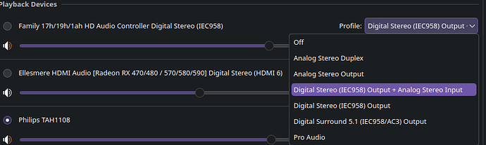

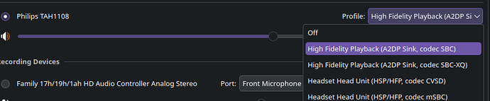

also here are the profiles both of my audio outputs that dont work
Bluetooth Headset
Speakers
it fixed my speakers but bluetooth headset is still broken
