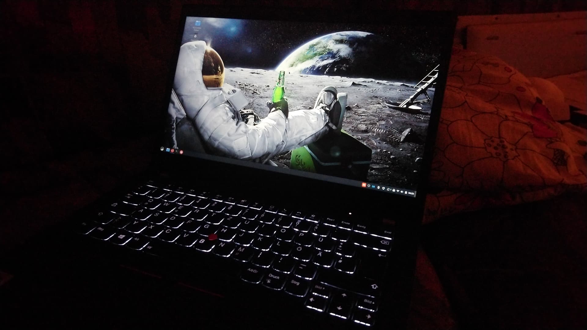

All done, up & running:
I went the path of least resistance, since I wanted the Thinkpad ready for work tomorrow (well, today actually, it’s 4:30 am here):
  • Started old laptop from my Ventoy stick, cloned SSD to an NFS share on my NAS.
  • Started Thinkpad from Ventoy stick, cloned the 256GB (122GB used) back from the NAS to the 512GB NVMe.
  • Started Ventoy stick with EOS live + persistence.
  • Used gparted to move swap partition to the end of the new drive, extended EOS partition to use rest of available space.
  • arch-chroot’ed into the new system, changed /etc/hosts & /etc/hostname.
  • Ran reinstall-kernels, which in turn created new machine ID and new entries in /efi/loader/entries.
  • Booted into new system (with new machine id), removed old entries in /efi/loader/entries, rebooted again.
  • All good so far, now for the rest:
    • Shut down Syncthing, deleted cert.pem & key.pem in ~/.local/state/syncthing/, restarted Syncthing (new ID), changed machine name, reconnected with other Syncthing devices.
    • Modified player name for squeezelite (Lyrion client) in Autostart.
    • Set base volume in alsamixer.
    • ha-battery-sensor needed no modification, since it takes the hostname to create a sensor for Home Assistant. (Which in turn shouts at me when I let my laptop battery drain too low.)
    • Installed intel-media-driver to get VAAPI support for hardware video decoding (Firefox!).
    • Reboot, start Lyrion music player, quick test, relax, photo, beer
No, wait! No more beer in the house, damn! Send me some… :wink:
