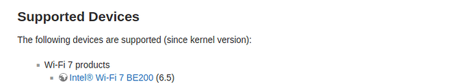

Ya … i also see it should be supported since kernel 6.5.
