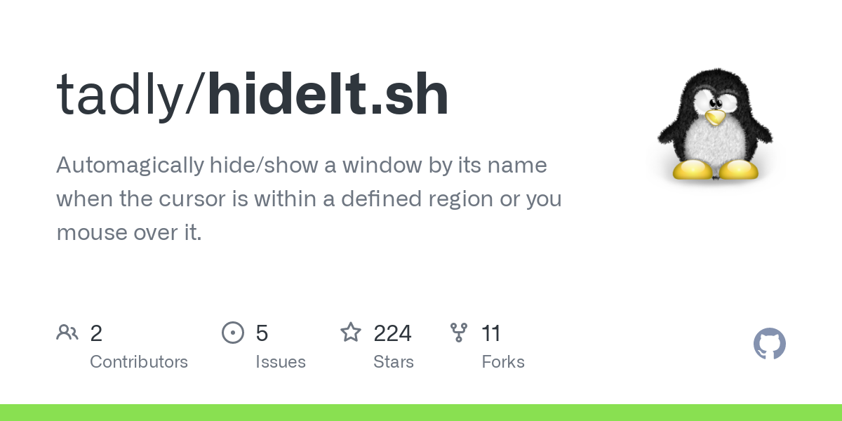

polybar works fine with bspwm - and you can toggle autohide with the mouse or set a key bind for it using hideit.sh
