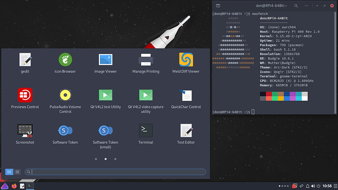

So I updated the eeprom on the pi400 and still didn’t have any luck getting it to load up on the usb external SSD or a usb thumb drive. I tried various images such as raspberry pi and manjaro. The issue has something to do with the bootloader or uuid but I’m not sure.
So after @Pudge’s suggestion which i had totally forgot about i used my laptop to run the installer and image the micro sd that came with the pi 400. Yes it’s quite small but it worked without a hitch. Now i am going to try and boot the pi 400 on it.
Edit:
Screenshot_2022-06-26_11-47-59
For now i will use micro sd cards until i figure out what the issue is with the boot on usb. Going to pick up some faster micro sd that are larger.

I did update the firmware and also the eeprom but sadly it seems it’s still not wanting to boot on the ssd drive. On the micro sd it boots and comes up pretty quick. On the ssd it’s just not working. :angry:
