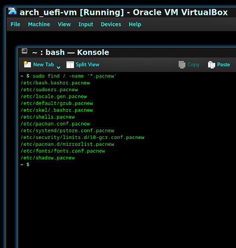

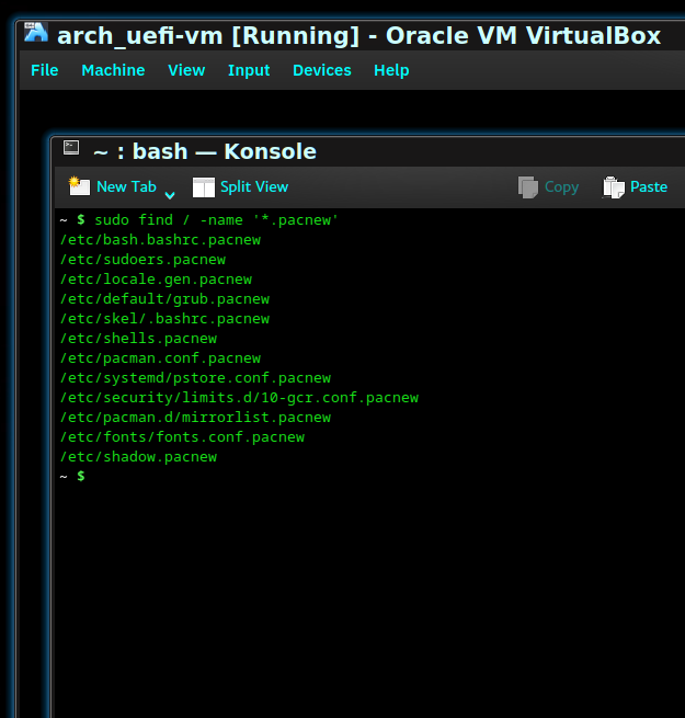

Of course, there are some pacnew files to deal with:
Easy enough so far. Then I had to manually rebuild yay; after that I updated my AUR packages. Finally I cleaned orphans.

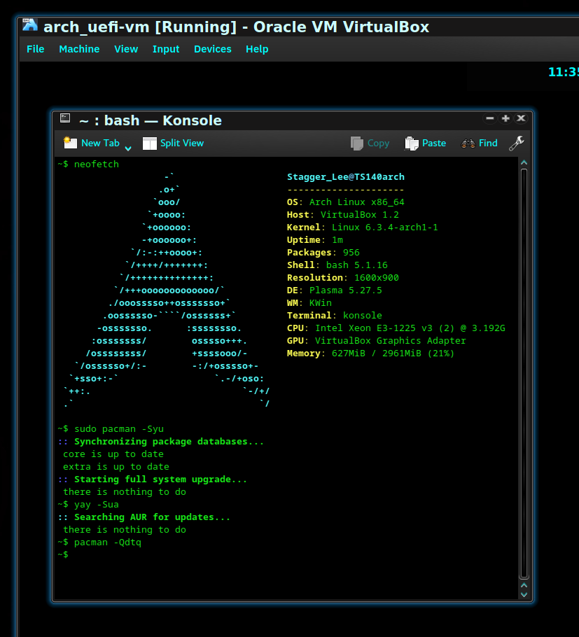

Now will it boot?
Yep:
That was kind of fun. I certainly wouldn’t recommend not updating for 3 years, but as you can see, it can be done.
