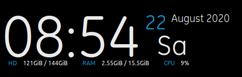

Gotham Conky

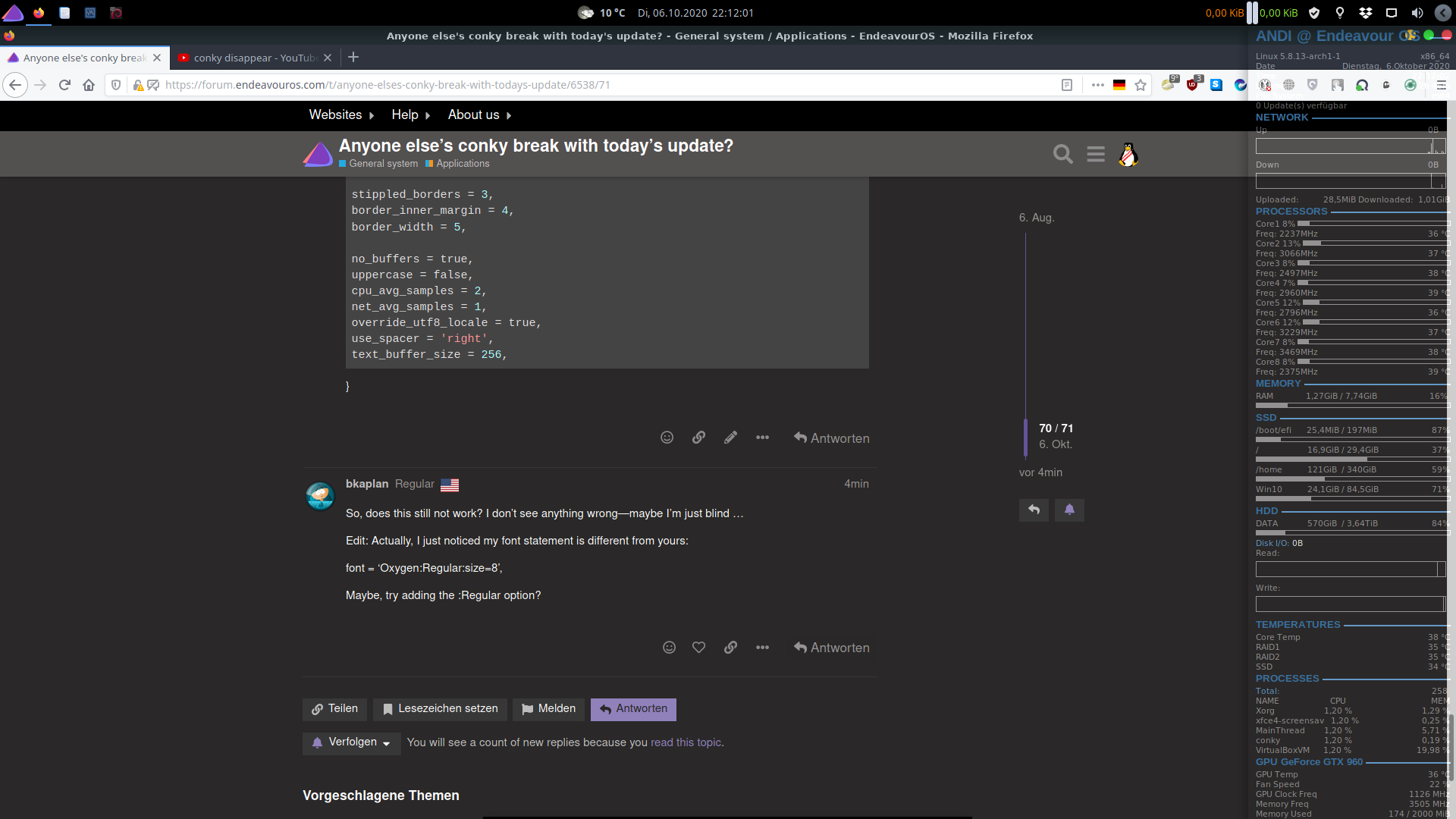

So, does this still not work? I don’t see anything wrong—maybe I’m just blind …
Edit: Actually, I just noticed my font statement is different from yours:
font = ‘Oxygen:Regular:size=8’,
Maybe, try adding the :Regular option?
Edit 2:
I remember I also changed my maximum_width statement to a minimum_width statement, which seemed to give me a better result.

It isnt really better :anguished:
And if you click on your browser header, it doesn’t come to top?
No
