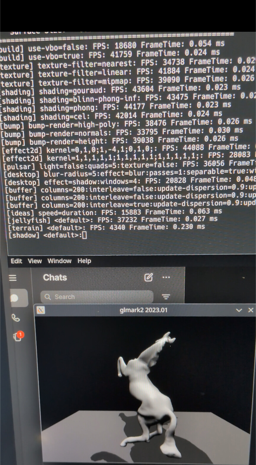

The nice thing is I can just run glmark2 and it will eventually crash. So that will give me a solid test for the new mesa package and then once passing I can install vulkan and see if there is any difference in performance
So the new mesa module made it to extras-testing and installed it, did a reboot and ran glmark2

This got me to pass the glmark2 tests. Have only briefly tried Minecraft but that usually fails pretty quick.

  Sections:
[acefour@acefour-1 ~]$ glmark2

You have to realize that some issues may come from the game platform itself. I see you are using a lot of parameters in your cmd line.
After installing extra-testing/vulkan-radeon 1:25.2.2-1 the glmark2 test fails with ring timeout
u
Sep 04 11:54:42 acefour-1 kernel: amdgpu 0000:03:00.0: amdgpu: Dumping IP State
Sep 04 11:54:42 acefour-1 kernel: amdgpu 0000:03:00.0: amdgpu: Dumping IP State Completed
Sep 04 11:54:42 acefour-1 kernel: amdgpu 0000:03:00.0: amdgpu: ring gfx_0.1.0 timeout, signaled seq=31265, emitted seq=31268
Sep 04 11:54:42 acefour-1 kernel: amdgpu 0000:03:00.0: amdgpu: Process information: process kwin_wayland pid 8750 thread kwin_wayla:cs0 pid 8801
Sep 04 11:54:42 acefour-1 kernel: amdgpu 0000:03:00.0: amdgpu: GPU reset begin!
Sep 04 11:54:43 acefour-1 kernel: amdgpu 0000:03:00.0: amdgpu: MODE1 reset
Sep 04 11:54:43 acefour-1 kernel: amdgpu 0000:03:00.0: amdgpu: GPU mode1 reset
Sep 04 11:54:43 acefour-1 kernel: amdgpu 0000:03:00.0: amdgpu: GPU smu mode1 reset
Removed vulkan-radeon and it still fails in the same spot on the glmark2 test

Yeah weird. It worked twice in a row for me until I installed vulkan-radeon then doesn’t. Uninstall vulkan-radeon and still not working. Tells me something else is causing this to flake out. Just have to let the Mesa guys figure out as before I didn’t have all these kernel params before everything started to fail
I have vulkan-radeon installed. I also have all the 32 bit library files installed. It is setup for hardware acceleration as per the arch-wiki. I have settings in /etc/environment for that.
Edit: I am also running ECO mode at only 65W so I’m sure it could be higher if i set 100w and also gaming mode on the CPU.
Ok, with the same kernel params, vulkan-radeon/mesa from extra-testing, plus mod flags I get through the glmark2 tests again. I tried this without the kernel params and the performance is cut in half.
EDIT: sigh, I see the typo with the radeon module flags. Let me fix and rerun.
EDIT2: bottom output updated with correct values and run, which passed.
