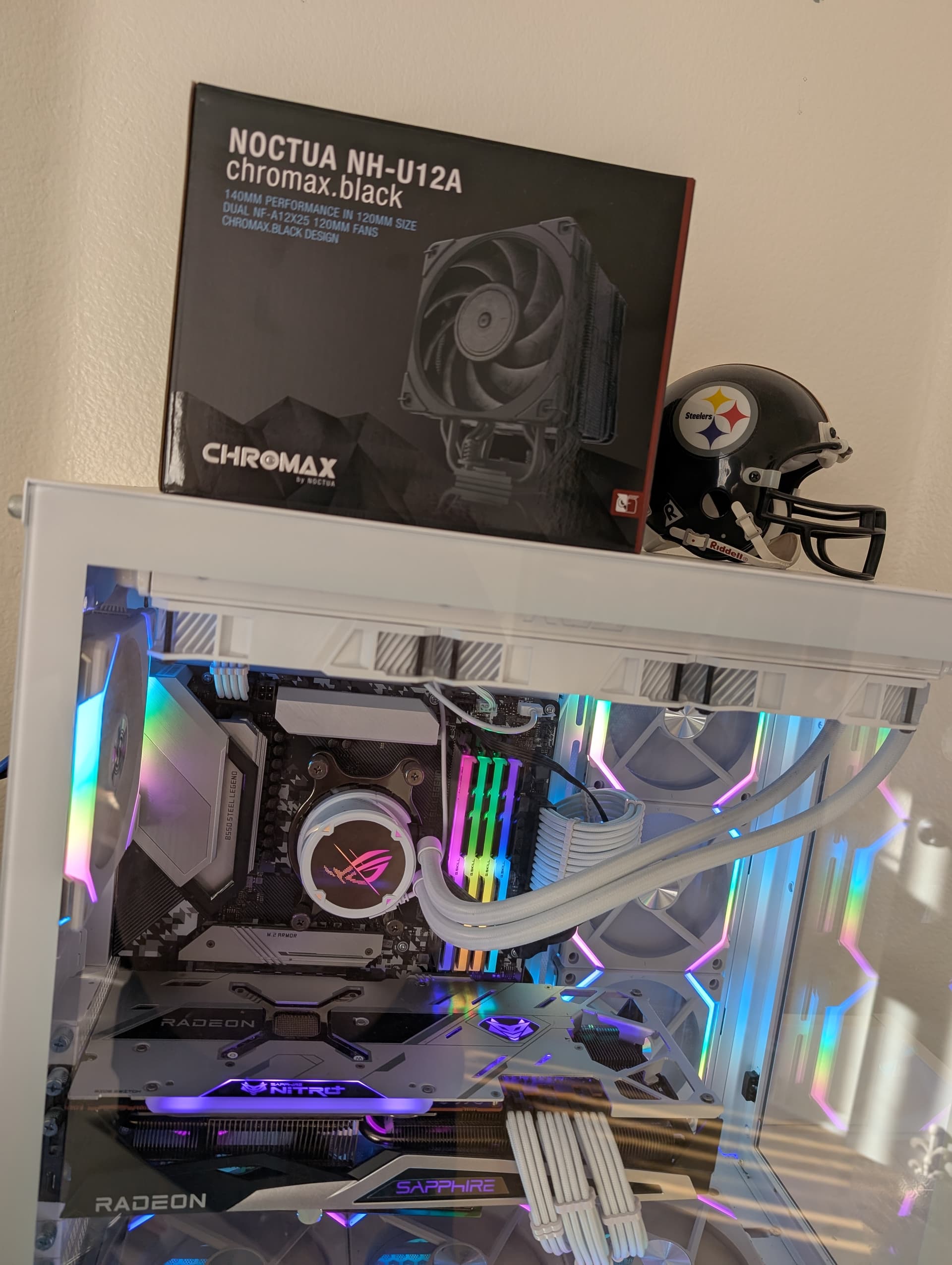

So I built my computer going on 2 years ago. . . I went Asus AIO. . .
I’ve been contemplating air cooling. I like the simplicity, I also really want this to be a very long term computer for me and feel like air cooling makes more sense. It lasts forever basically. Even if the fans work you’ll have passive cooling until they get replaced.
This Noctua nh-u12a bundle (I’m still waiting on the white cover to go with the rest of my build, it’s back ordered) was on sale . . . .
I’m still undecided if I’m returning it or not. Where are you all at? Water vs air . . . vote

This is what mine will look like in the end (theoretically)

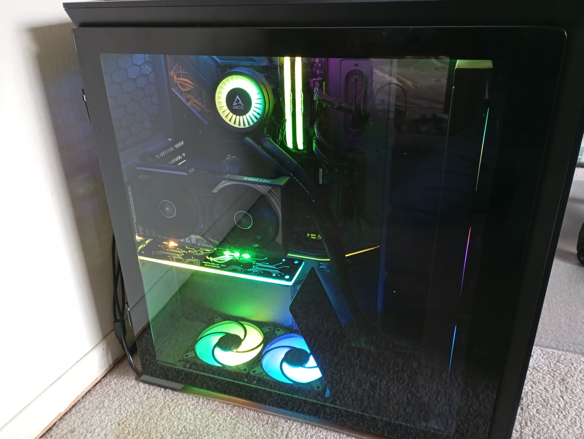

Well…I have a large case…Phanteks Enthoo 719 (the Gray/Black case that they no longer make) & I’m running an Arctic Liquid Freezer 3 420… My temps at full load never go over 60c.
AIO all the way for me— I’ve made several custom loops & used several different air coolers over the years & the Arctic just works without any fuss. I mounted the GPU vertically & custom-made an air deflector for it. The radiator blows out the front & I have 3 140mm fans blowing down + the 2 120mm blowing up to the GPU. The Arctic has 3 140mm blowing out the front with 10mm spacers between the fans & the radiator to reduce the fan “dead spot” problem. The fans are in suction.
