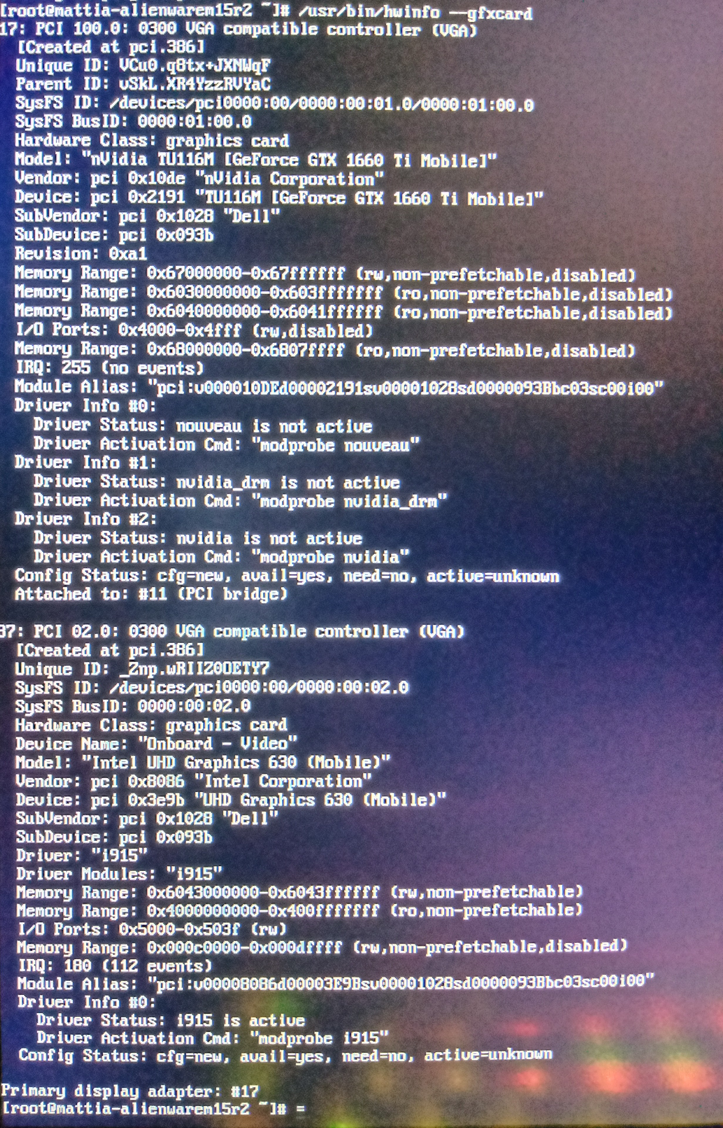

Please post the output of
/usr/bin/hwinfo --gfxcard
Emmmm all of it?
Would be fine. I know it’s a little more than 10 lines. It’s two GPUs.
Ooook her we go
IMG_20200516_213446524
is this ok?
I have to eat I will be back
Not ideal, but good enough for what I wanted to see.
So now we know that your Intel driver is obviously up and running. The problem seems to be your Nvidia card. Neither nouveau nor Nvidia driver are working.
Looks like to me if i’m reading this right is that the Nvidia is not the active driver? Intel is active? But Nvidia did install at least from the install log it looked as though it did but maybe not configured to load? :man_shrugging:
That’s my read too. Out of three possible drivers only the Intel one is running.
