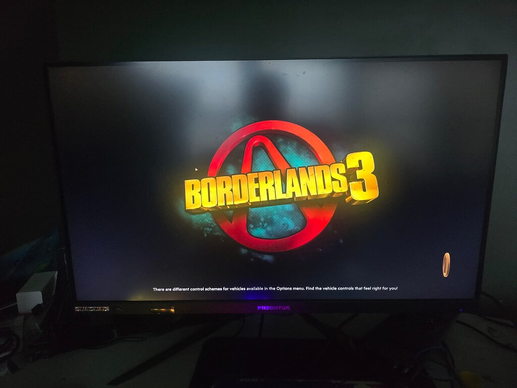

Yes its a fresh install. I did install the vulkan and 32 bit vulkan libraries. Games are still crashing/not launching at all. Wondering if there’s something missing I need to wait for?

This fixed it. Needed to build the mesa-git package from AUR and run pkgbuild.
The yay install failed.
Thank you!
