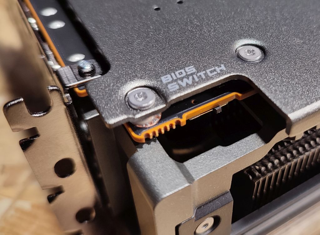

I know all of my AMD cards (6700xt, 6950xt and now 9070xt) all had switches on them for fan curve settings - maybe you have yours in quiet mode or whatever they call it?

You mean, like, physical switches?
Yes. Correct - for example:
I have no idea if it will actually help - but I thought it’s something you could try.
Lol, didn’t know about that. Removing that card from my case is painful but I’m getting good at it, no switches found though.

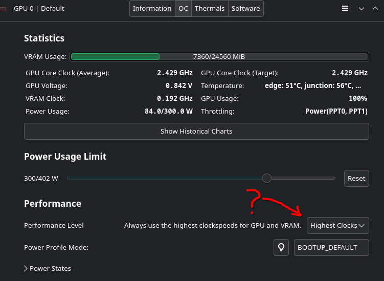

What about the Performance level settings ? There are options for lowest clocks and highest clocks besides automatic and manual. Only the latter one would require the overclocking settings to be unlocked via the ppfeaturemask if I’m mistaken and would also be required to enable the power state configuration.
Lact isn’t that intuitive in that regard, unfortunately.
I use it primarily only to achieve lower power consumption for usual desktop use-cases by limiting it to the lowest power states. And by undervolting my RX 6600 slightly and that way it usually only consumes 4-7 watt. You didn’t need to use nvtop to check the individual clock speed as lact also displays these information and you could activate the historical chart to check the behavior.
You mean this? Tha’t’s actually the first thing I tried, just forgot to write that in my post.

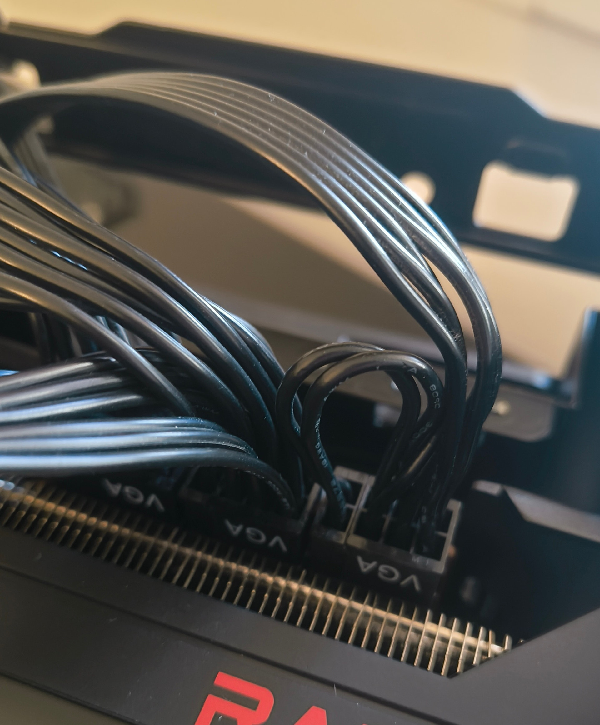

This might be a long shot but did you connect all power pcie cables to the card?
And does your motherboard has a separate pcie power connector to the motherboard to feed the pcie slots? Some motherboards do have this connector to provide enough power to the pcie bus

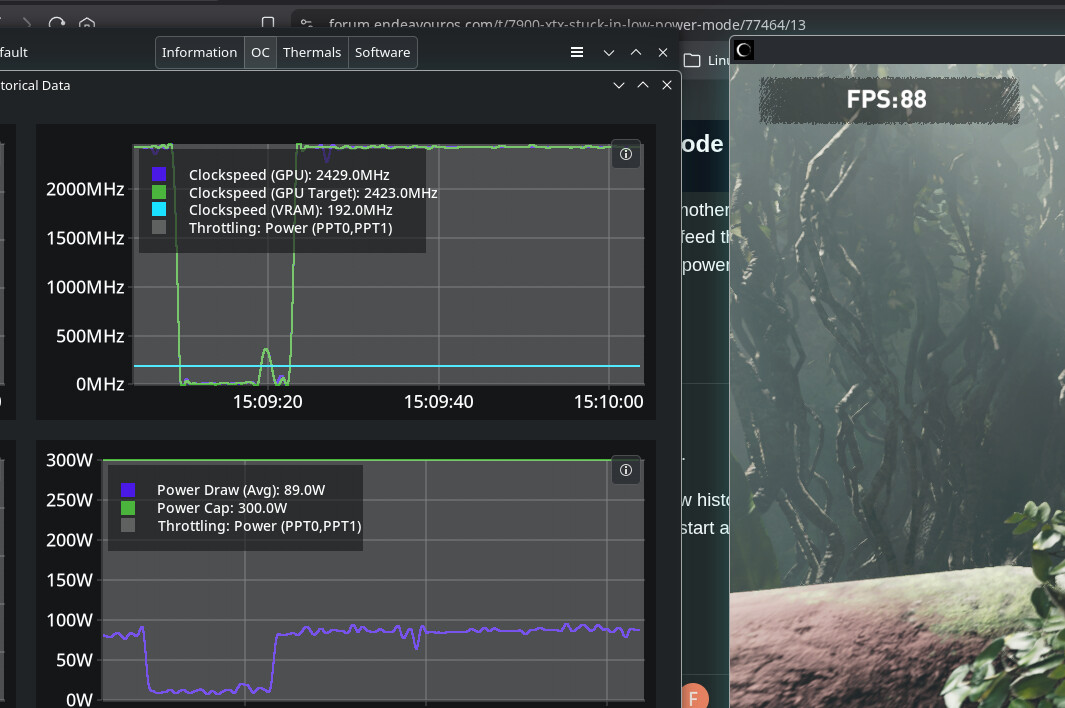

Enable the “show historical charts” in the options next to the window controls in the upper right and start an GPU load / game, just to check if the targets are met under load.

I did but one of them is like this, could that be a problem?
VRAM stuck at 192…
