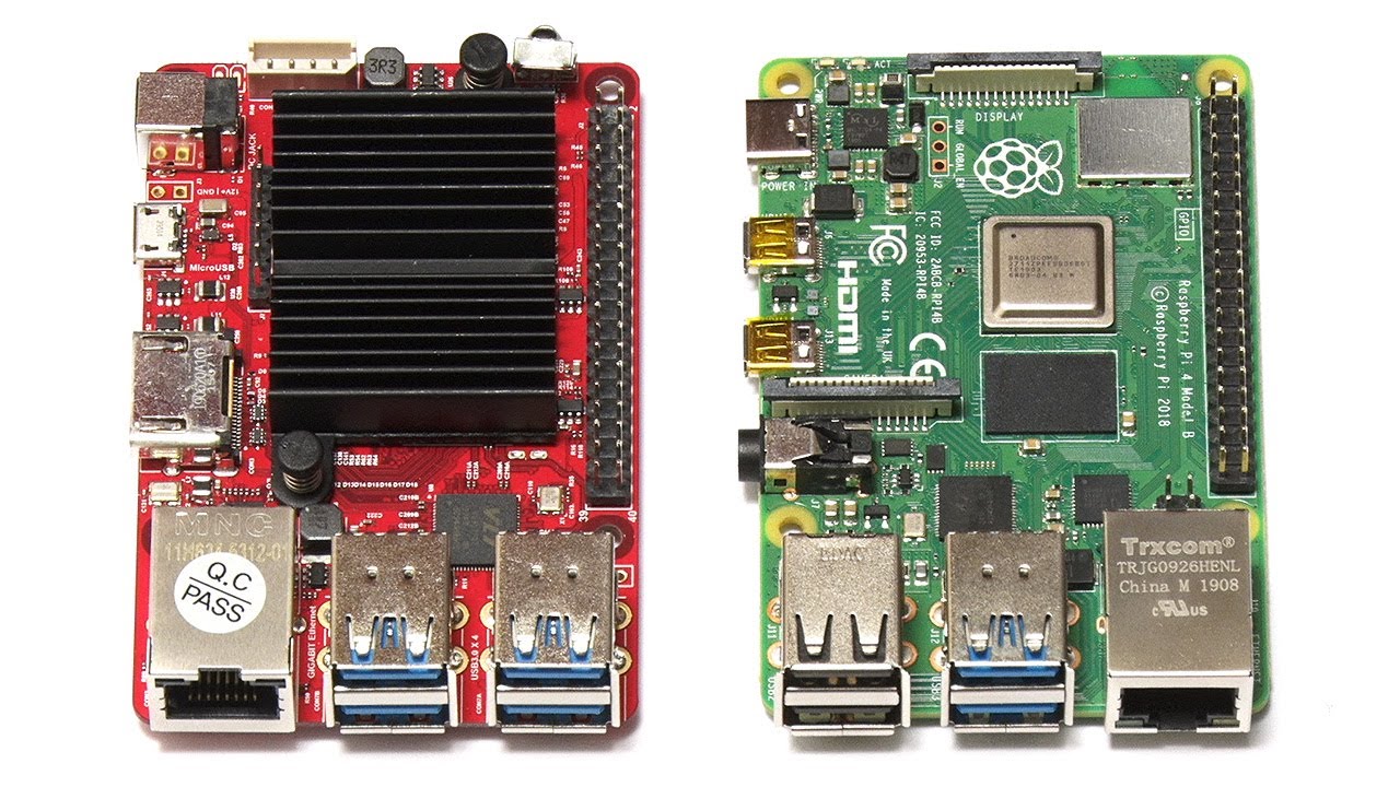

Which is one of the three devices that I used for testing with EndeavourOS-ARM. Observing htop, ram useage is usually 1 GB or less on the Rpi4.
The three ARM devices I have for testing are
Odroid N2 with 4 GB RAM
Odroid XU4 with 2 GB RAM
Raspberry Pi 4b with 4 GB Ram
All worked well including the XU4 with only 2 GB RAM.
By the way, they are listed in the order of which one works the best for an EndeavourOS with DE system.
The Odroid N2 the main CPU of the N2+ is based on big.LITTLE architecture which integrates a quad-core ARM Cortex-A73 CPU cluster and a dual core Cortex-A53 cluster with a new generation Mali-G52 GPU. On the S922X SoC, the A73 cores run at 2.2GHz and the A53 cores run 1.9GHz. Plus the Mali-G53 GPU is the newest and best of the three I tested. The N2 is 64 bit and Arch Linux Arm provides a 64 bit image for the N2
I have the Odroid N2, the N2+ is brand new and slightly faster.
The Odroid XU4 has 8 32 bit cores Samsung Exynos5422 Cortex™-A15 2Ghz and Cortex™-A7 Octa core CPUs and a Mali-T628 MP6 GPU.
The Raspberry Pi 4 has a 64-Bit quad-core processor all cores running at 1.5GHz and aVideocore VI GPU.
