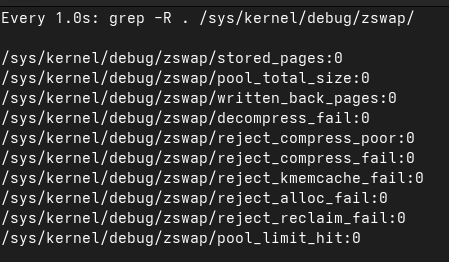

I have switched back to zswap for the time being. I haven’t found any way to “benchmark” the performance of either to see which of them is more performant or more efficient. I haven’t been using my system that heavily either for it to hit the swap. I’ll be monitoring the situation :wink:
zram and zswap work only when SWAP usage comes into play. If only RAM is being used and SWAP is not being used then they do not come into play. Is that a correct statement to make?
Also zswap checks if the swap page can be compressed or not. If not then it writes to SWAP file or SWAP partition. While this is not the case with zram. zram always compresses, irrespective of level of compression that it will achieve. So in this case zswap appears to be more efficient than zram but not more effective. Will this also be a correct statement to make?
Efficient in terms of CPU cycles and energy consumed. Effective in terms of not disk thrashing, i.e. NVME or SSD disk thrashing.

I have switched to zswap plus swapfile. I just use my system as I normally would and I am monitoring the swap usage. So far I haven’t noticed any slowdown in the way of system’s operation let alone being unresponsive.
For now I cannot take your categorical statement at face value until I have used this setup for enough long period.
Current parameters for zswap:
 grep -r . /sys/module/zswap/parameters/
/sys/module/zswap/parameters/enabled:Y
/sys/module/zswap/parameters/shrinker_enabled:Y
/sys/module/zswap/parameters/max_pool_percent:20
/sys/module/zswap/parameters/compressor:lzo
/sys/module/zswap/parameters/zpool:zsmalloc
/sys/module/zswap/parameters/accept_threshold_percent:90
Current RAM and swap usage:
 free -h
               total        used        free      shared  buff/cache   available
Mem:            14Gi       4.5Gi       4.4Gi        47Mi       6.4Gi        10Gi
Swap:           15Gi          0B        15Gi
Current zswap usage:

Your system is not swapping at all. Have you tried to provoke swapping with stress-ng? Lets see how your system behaves when it uses your 15 GB of swap.
Then I don’t understand your categorical statement below since zswap is enabled by default:
It seems to be based on an assumption rather than the result of the test you posted above.

No. And I don’t think I would do that. I am not interested in “provoking” a situation which has no relevance for my daily usage of my system by filling my zswap and swapfile with “none sense data”.
I am interested to see the difference between these two options in my ordinary day to day usage. So far I haven’t seen any difference.
