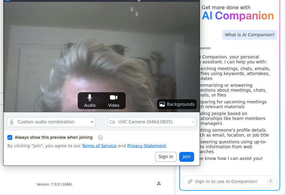

I’m shocked it worked. It never worked in Endeavour X11 Cinnamon but always worked in Solus X11 Budgie. No I have no idea why.
this worked in Endeavour Wayland Budgie, now.
EDIT: good god I need a haircut
Circumstance: launched standalone from my employer link/account. Got the famous ‘open app’ prompt. Standalone opened, camera and mic on, main window launched.
Fail: launching standalone from Zoom itself. I get crickets and the AI thingy window.
Opening Zoom via browser: I hate that so haven’t tried it some time.
Deduction? Successful launch because of verified account?
Don’t know
I uninstalled plasma, cosmic and blew away my .config and the .cache. Followed
zoom now works and so does the share. Now to add my menu back
outstanding, cheers
So follow-up, I used JaKoolIt Hypr configs. Apparently they are moving the LinuxBeginnings github repo and were not kept up to date. A lot of broken configs. I stripped down an install to what I use and fixed the issues such as swww becoming awww.
Something with https://github.com/LinuxBeginnings/Hyprland-Dots/blob/main/config/hypr/configs/ENVariables.conf was breaking Zoom rendering. I nuked that file all together and Zoom rendered normally.
