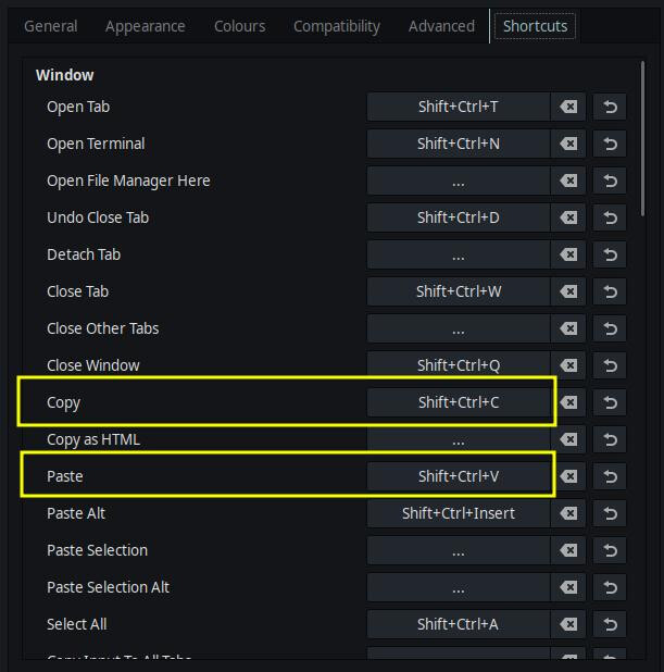

When you select with the mouse, similar to pasting, you also need to press Shift.
CTRL+Shift+C
You could also change the shortcut, though I don’t think that’s a good idea.

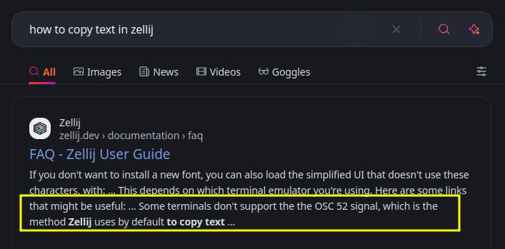

Are you sure this isn’t a zellij problem, then? Maybe the copy shortcut is different when you launch it. Have you read their documentation?
From their website: https://zellij.dev/documentation/faq
Copy / Paste isn’t working, how can I fix this?
Some terminals don’t support the the OSC 52 signal, which is the method Zellij uses by default to copy text to the clipboard. To get around this, you can either switch to a supported terminal (eg. Alacritty or xterm) or configure Zellij to use an external utility when copy pasting (eg. xclip, wl-copy or pbcopy).
To do the latter, add one of the following to your Zellij Config:
copy_command: "xclip -selection clipboard" # x11
copy_command: "wl-copy"                    # wayland
copy_command: "pbcopy"                     # osx
Note that the only method that works when connecting to a remote Zellij session (eg. through SSH) is OSC 52. If you require this functionality, please consider using a terminal that supports it.
