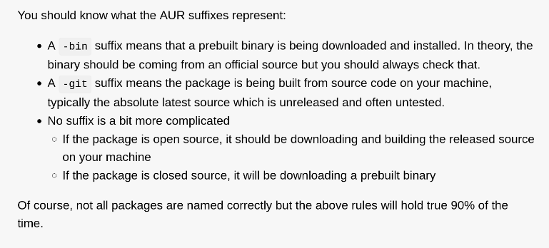

When you use yay, look at the source of the software. If they are from official repos. Or if they are from AUR. When they are from AUR, look at the suffix to know what variant you are installing.
Is there some other way to identify a package which will install from git apart from looking for the presence of the suffix -git in the package name?

For open-source software, if you’re after the pre-compiled binary version, you want the -bin version.
I think you can always check the PKGBUILD to know where and what is the source of the software.
I took this screenshot from this post with good explanation
thanks @cactux and @Bink
Thanks @thefrog
Do you mean you want to know if the package will be built from source?
The only way to know that is to read the PKGBUILD.
Yes @dalto I wanted to know if the package will be built from source or will binaries will be downloaded and installed directly from the repo.
You would need to read the PKGBUILD and see what it is actually doing.
If it is built from source, you will see the build commands in the PKGBUILD. If it is a binary, it will be unpacking and copying files but not building anything.
However, the vast majority of binany packages end in -bin so if it doesn’t end in that, it will probably be built from source.
