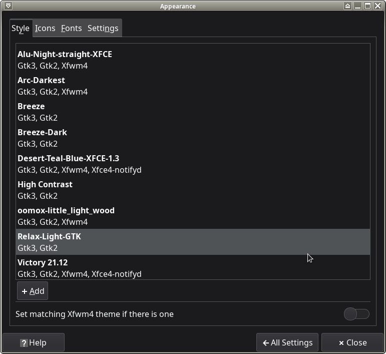

Ok, so I am not understanding how XFCE customization works.
Lets look at this theme - https://www.xfce-look.org/p/1692847
Should be light grey-ish, right?
On my system it looks like this -
Why?
How do I get it to show correctly?
This system is running Arch, not EOS if that matters.
Thanks in advance for any help.

For some reason it turns dark and I don’t know where to change it.

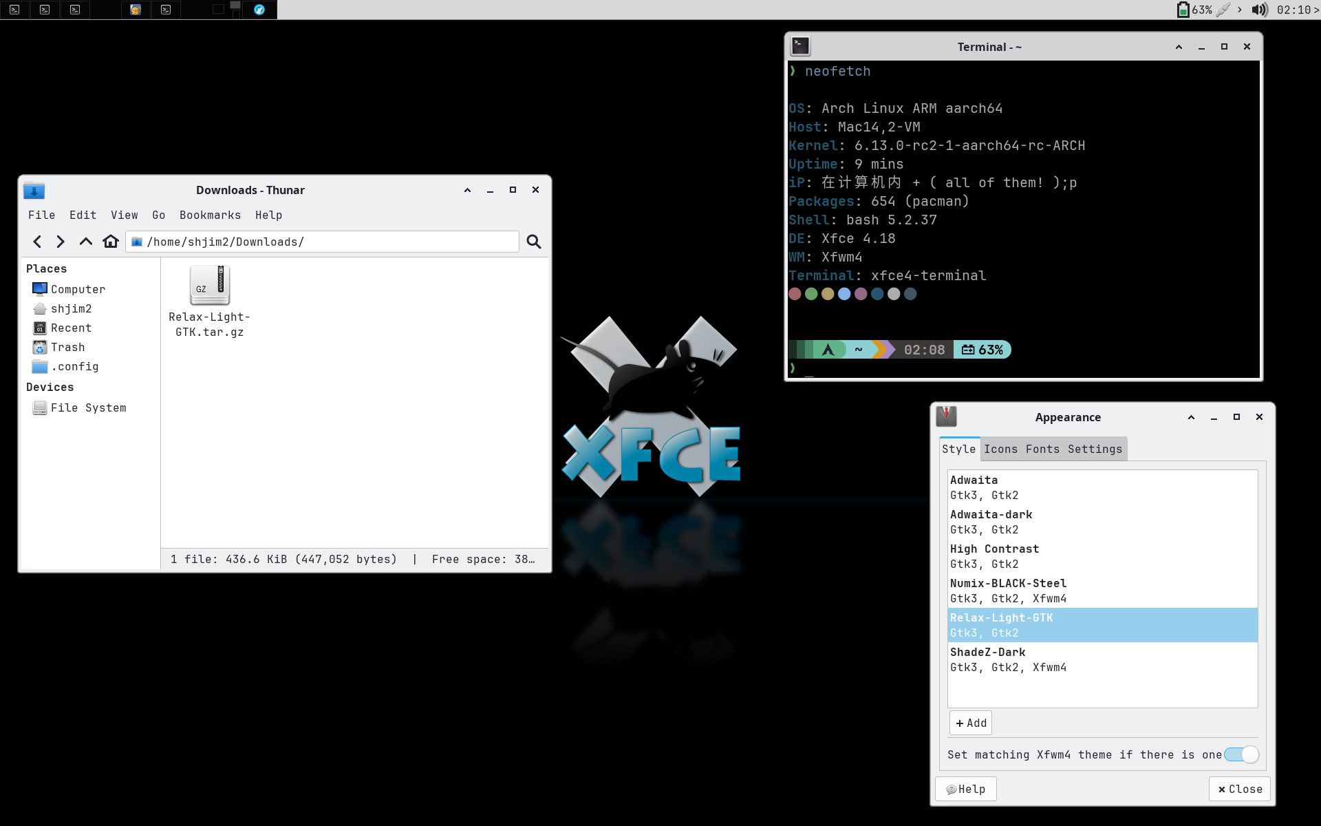

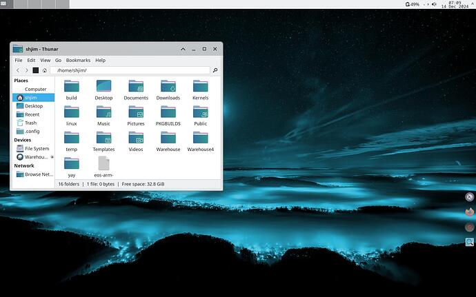

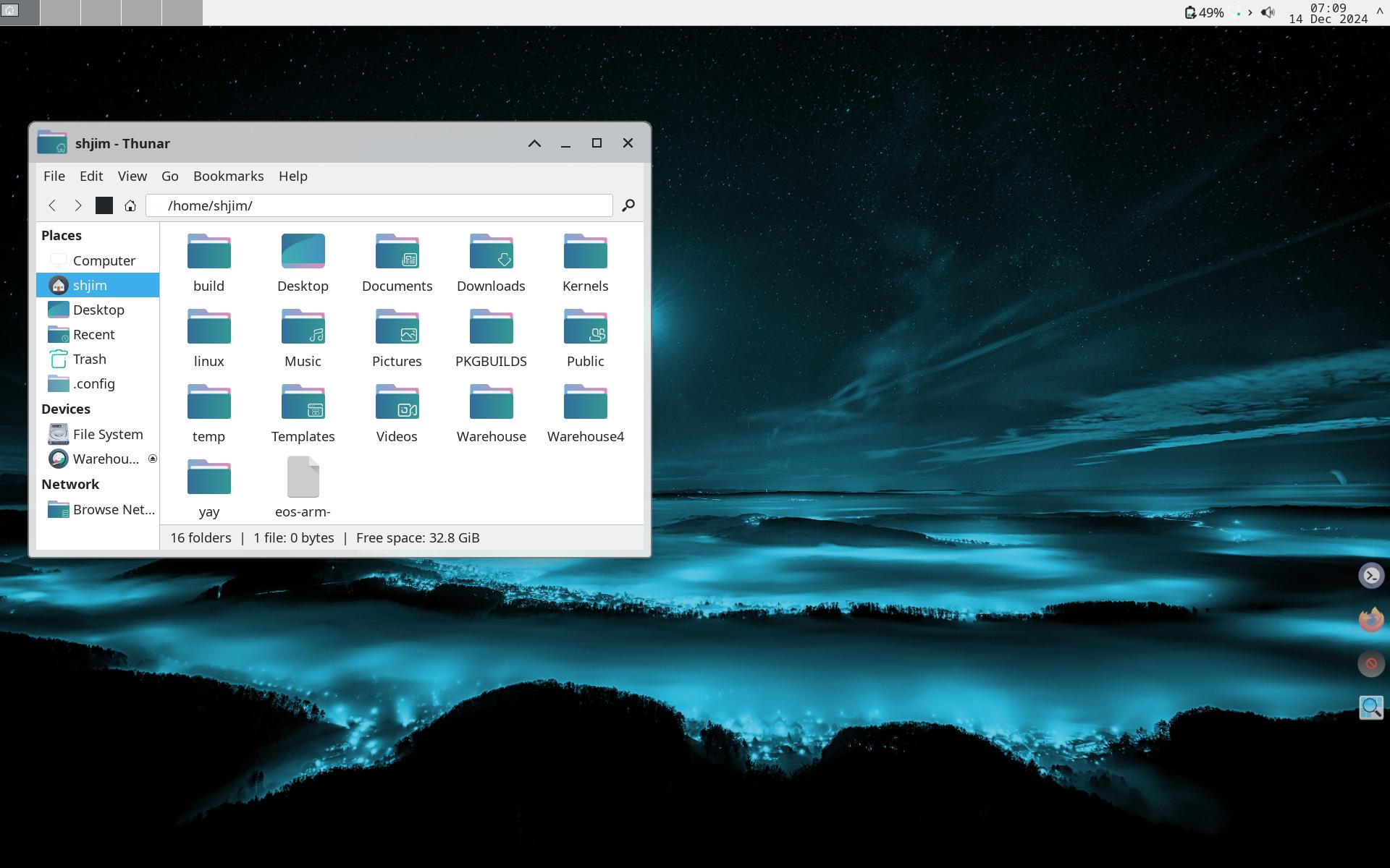

Meanwhile I installed Arch-XFCE
Did the following in terminal:
sudo pacman -S archlinux-keyring
sudo pacman -Syu
[https://itsfoss.com/install-yay-arch-linux/](https://itsfoss.com/install-yay-arch-linux/)
yay -S ocs-url
then selected Install on https://www.xfce-look.org/p/1692847
and answered the questions
It works. Even the taskbar is light.

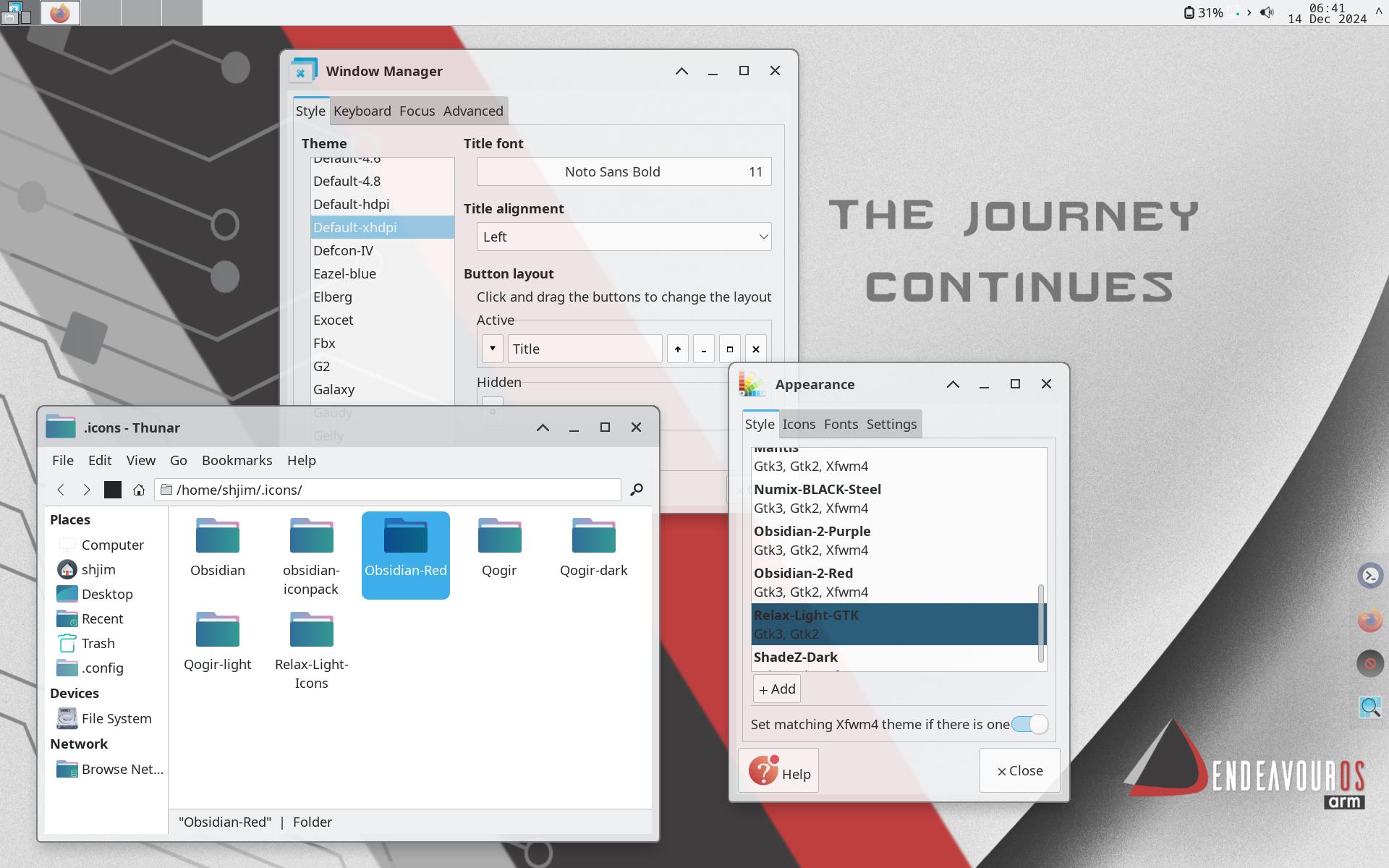

Have you tried any of the themes from the AUR? I’m currently using catppuccin-gtk-theme-mocha, which includes everything you need. While I can’t be certain as to why the screenshots don’t match what you’re seeing, it’s important to have an xfwm4 theme that matches the main theme (in Settings → Window Manager → Style.
