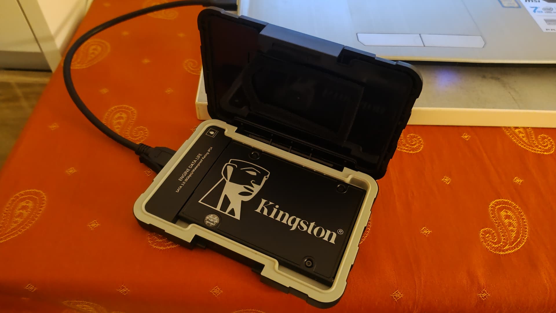

Idk how, but I might have to reinstall endeavour… SystemD boot doesn’t appear anymore, here’s what happened
As soon as it got installed I tried to restart, hit f11 so the boot manager would show the other SSD, booted into KDE and it was giving me the error: incorrect password(Idk why, but anyway, maybe in a hurry I wrote the password badly and can’t remember it), I unplugged the external SSD where endeavour os is installed, I check the windows 10 and it works, I plug the SSD back in and all I see is the boot manager of windows TWICE, once from the SSD where Linux should be at and once from the SSD where windows is at
I try the Linux SSD and in windows it boots
So I guess it was windows updates that messed up the systemD since I booted it up with Ethernet in and it did windows updates
Should I try reinstalling it with Grub instead of systemD and maybe gnome instead of KDE? I’m a bit confused , especially cuz it should have worked, but it didn’t, good part is that window 10 is intact on the Intel SSD, but Linux not as much on the Kingston SSD :confused:
Can someone experien to my dumb head what happened?
I feel kinda sad :sob:
