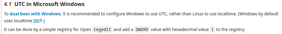

Making Windows use UTC time like Linux is probably not the best option. You can edit the registry to make Windows use UTC time, but this could potentially cause more problems than just making Linux use local time.
To dual boot with Windows it is recommended to configure Windows to use UTC, rather than Linux to use localtime. (Windows by default uses localtime [1].)
System clock synchronized: yes
NTP service: active
RTC in local TZ: yes
ntp service needs to running
timedatectl set-local-rtc 1
In windows i make sure is set to correct time and date and time zone etc.
Then set in linux with above command. I’m not sure how it works in other time zones. Or setting Windows with UTC. I have never done that? For me this is how it works properly otherwise when you boot into windows the time is out by 4 hours.

"An OS that uses the UTC standard will generally consider the hardware clock as UTC and make an adjustment to it to set the OS time at boot according to the time zone. " Quoted from Arch’s wiki.
With the arch’s wiki suggestion, Windows already boots with the correct time.
I guess I’m asking why it is recommended for Windows to use UTC rather than linux to use local time. Only because all different users have different time zones?
