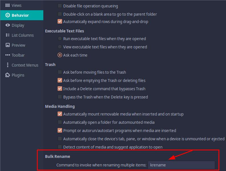

Nice. You could instead use Nemo’s built-in command for using a bulk renaming tool/command and add the same command, or a different one, like krename
The main variable is that you would need to have Thunar installed. :wink:
Oh wow thank you :slight_smile: Didn’t knew that was possible in Nemo, I searched for hours and the only solution that popped up was a Nemo action.
