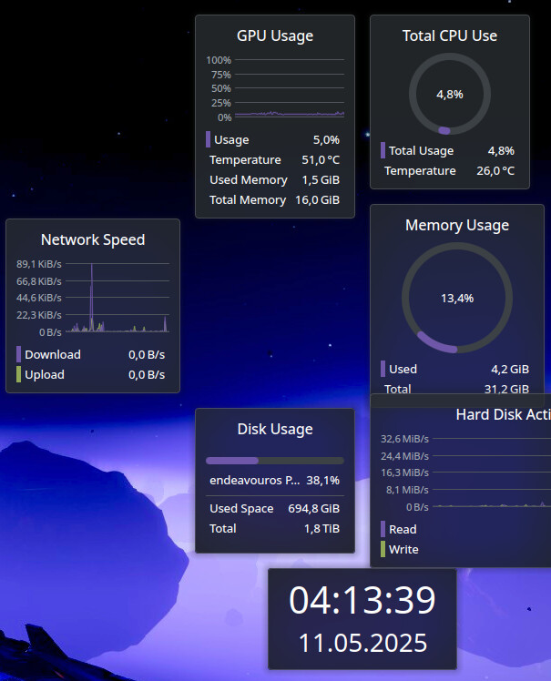

Hello, my system monitor widgets keep changing size everytime I restart my PC. It’s not always the same ones but there’s always atleast one or two. If there’s something I should add please tell me, thank You
KDE Plasma 6.3.5 Wayland

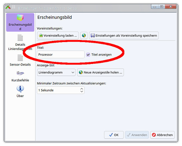

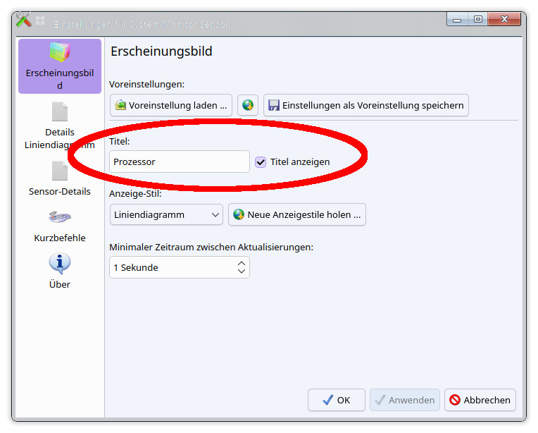

It may be enough to shorten the title in the widget settings

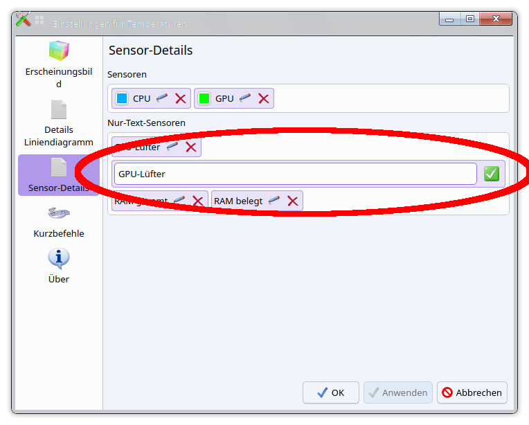

or shorten the names of the sensors
both have an influence on the width of the widget
Turns out some sensor names were not what was displayed on the widget, fe. “Read” and “Write” were actually named “endeavouros Read Rate” and “endeavouros Write Rate”. I think the widgets upon startup were resizing themselves to fit the actual names and then, for some reason, changing the sensor names displayed on the widget. This is most likely because I’ve used the pre-made widgets that somehow acted different. Thank you people for the help :slight_smile:
