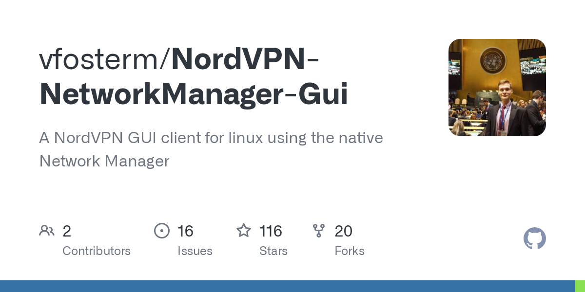

I use this gui for nordvpn, works really well and makes things very simple
That looks promising. I like the ability to see the available servers. Do I need to disable the terminal app or just install this on top of it?
Is it in aur?
Don’t think you need to disable the terminal app , couldn’t find it in the aur though. Im using the beta version, just download and follow the instructions. The gui for available servers is a godsend for me
