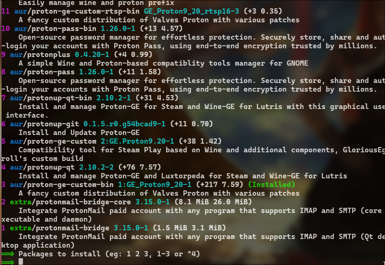

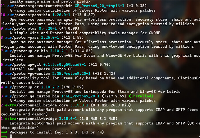

so if i wanna look for a package, like say proton ge, I just type
yay proton ge
And yay will search for packages I might want both from official and unofficial repos,
Then I just pick a number when i find what I was looking for, usually it’s one of the lower packages, I think yay sorts the relevant packages by popularity, with the lowest first.

ge appears the same (in output) as using -Ss. Is there a difference?

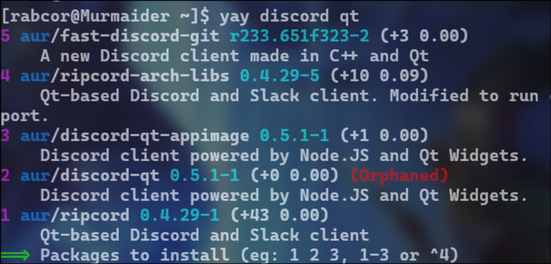

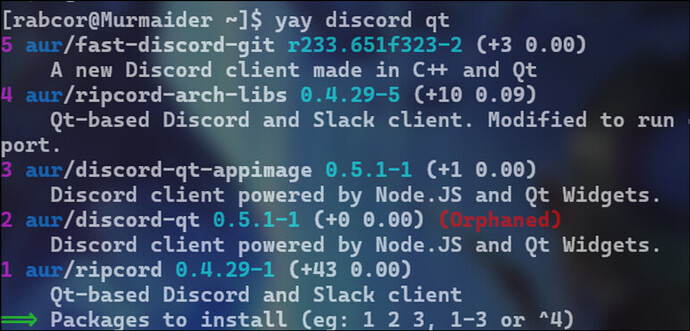

I could have used other examples, like discord qt.
You can use yay as basically a package search engine, just type search terms after yay and it’ll find you everything that contains that combination of words, like this:

I was simply asking if yay proton ge and yay -Ss proton were the same command. That’s all. Sorry if I was unclear
it is not the same command.
yay -Ss proton and yay proton would more or less give the same results, difference being only that the -Ss version does not prompt you for what package you want to install, it just shows you the results and exits.

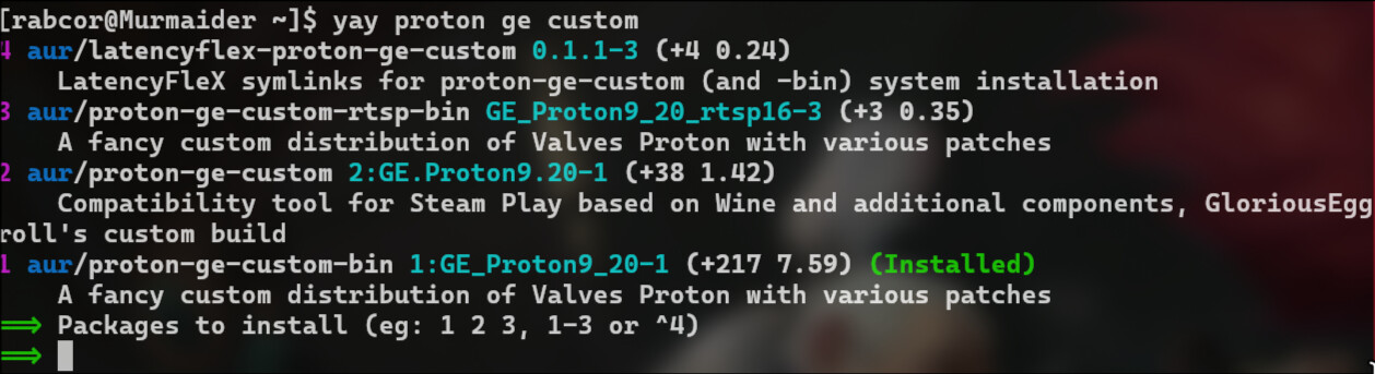

So for instance the command yay proton ge custom will search for all packages containing the 3 words proton, ge and custom anywhere in their title or description, reveal them to you, and prompt you for which of the results you would like to install.
There’s no limit to how many keywords you can add as far as i’m aware.
As you can see, by adding that extra keyword i narrowed down the results and it does not give me as many candidates as if i had only asked for proton.
At the bottom you can see it prmopting me to input a number to select a package to install, if I had used yay -Ss custom ge proton I would get the same actual results, but not the package selection prompt.
