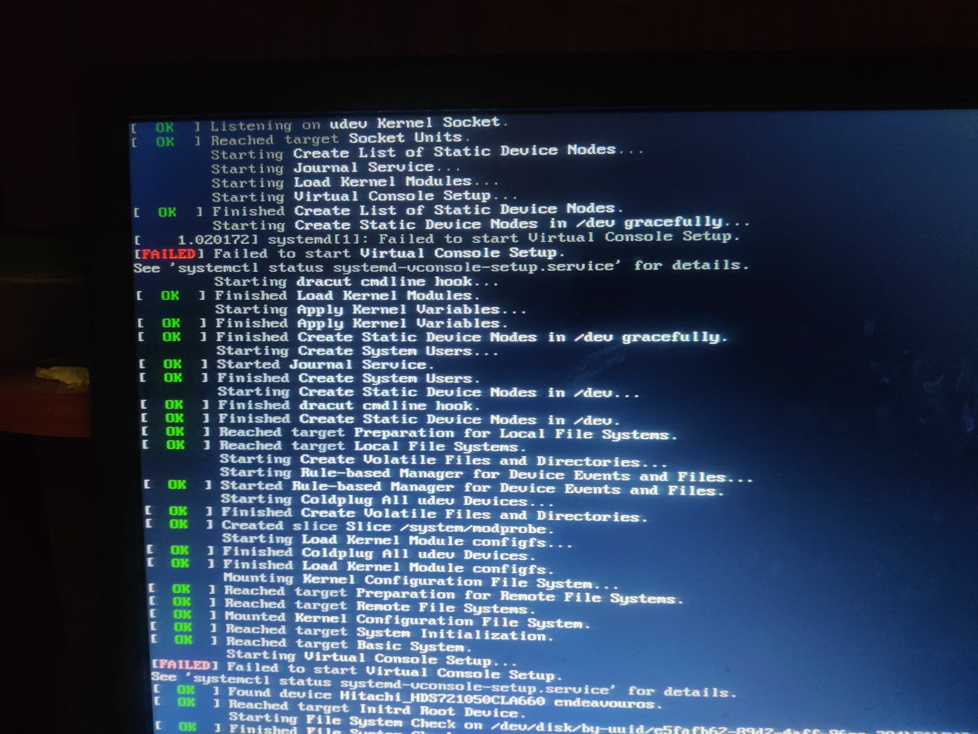

i started using linux just a week ago and i an having this problem since i dont know if it is a real error while my desktop works fine but i am still concerned if this cause any future problem
i dont know which log to send from where

does your system boot normally? If so, post the logs of systemctl status systemd-vconsole-setup

can you post the logs of this: cat /etc/vconsole.conf
Check your /etc/vconsole.conf.
Consult the man pages referred to above.
See also: https://wiki.archlinux.org/title/Installation_guide#Localization
‘KEYMAP=in’
just that
it should have some otehr lines, at least mine has ![]()
