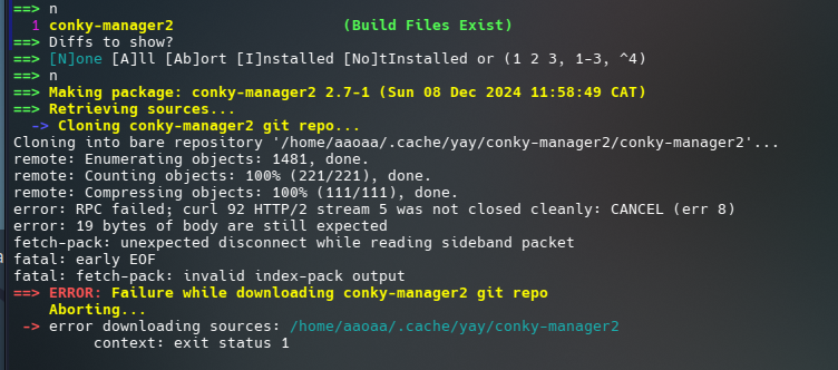

Every time I try to download Conky, the download fails and this error appears, even when my internet connection is at its best.
Is there another way to download it?

Manually remove the ~/.cache/yay/conky-manager2 directory and give it another try.

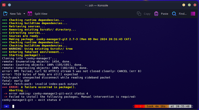

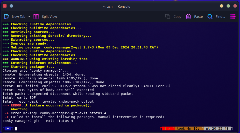

Gives an error
Has anyone encountered this error?

The way I see it you are trying a fork of the git version of the package, so the latest probably is 2.7.1 (see above). I could instaal this one. So if you type 2 after packages to install (and next hit the enter key a couple of times next) you can install that one.
Try clearing the yay cache for the package and re-download:
yay -Scc
and then
yay conky-manager2
if that doesnt work try
git clone https://github.com/zcot/conky-manager2.git
cd conky-manager2
makepkg -si
or
Manually Fix Corrupted Git Cache
If the cache is corrupted, delete it manually:
rm -rf ~/.cache/yay/conky-manager2
yay -S conky-manager2
