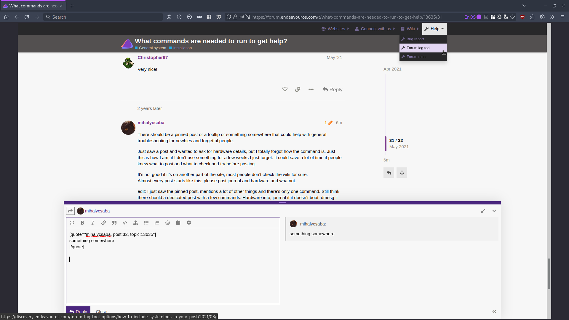

There should be a pinned post or a tooltip or something somewhere that could help with general troubleshooting for newbies and forgetful people.
Just saw a post and wanted to ask for hardware details, but I totally forgot how the command is. Just this is how I am, if I don’t use something for a few weeks I just forget. It could save a lot of time if people knew what to post and what to check and try before posting.
It’s not good if it’s on another part of the site, most people don’t check the wiki for sure.
Almost every post starts like this: please post journal and hardware and whatnot.
edit: I just saw the pinned post, mentions a lot of other things and there’s only one command. Still think there should a dedicated post with a few commands. Hardware info, journal if it doesn’t boot, dmesg if freezes etc.
Been here more than a year, opened that menu too once or twice, it never registered in my mind, it’s a little bit hidden away in my opinion. Pinned post is more visible. I just see the posts and the basic logs are missing most of the time.
