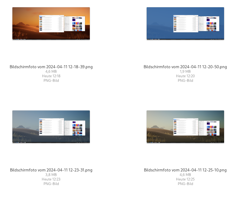

edit - added screnshot gallery from progress - befpre - 2x during - after transition
Found it. It must have been sth. in the png files provided. Metadata, transparency, …? No clue.
I saved them as jpg from withing gThumb and now it works. Any other conversion tool would do as well I suppose. May be even just re-saving them as png also.
Don’t forget to adjust the changed extensions in the corresponding xml file.
