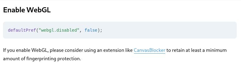

From Librewolf’s documentation:
https://librewolf.net/docs/settings/#enable-webgl
You can also set webgl.enable-debug-renderer-info to false so that it gives less info such as the GPU card name.
