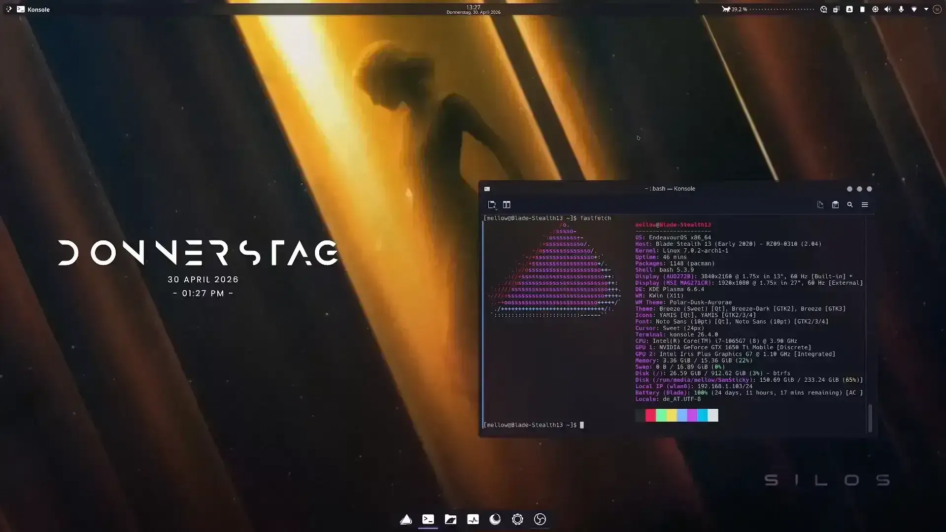

Ok I tested it myslef on my laptop, it works for me without issues. So again the question, how did you install it?
I just installed from the KDE Store and it directly worked, also relogged, rebooted and it always loaded after like 2-3 seconds.
x11-anim-wp-ezgif.com-optiwebp
(for my own sanity, this video clip is taken from x11, on a laptop with a 4k screen. due to the 6Mib size limit on this forum i had to heavily compress and cut this video i hope the fastfetch is visible enough for you to see its on x11, if you zoom in it should work. also the DE is not yet completly customized, im working on it :sweat_smile:)
