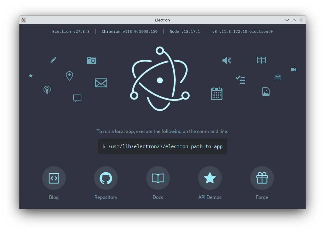

In a recently installed vscode-oss-1.86.2-1, I first installed the German Language Pack under “Configure Display Language”. After that vscode needs to restart, but when closing the following Electron window opens:
I have no idea what i should do with this.
