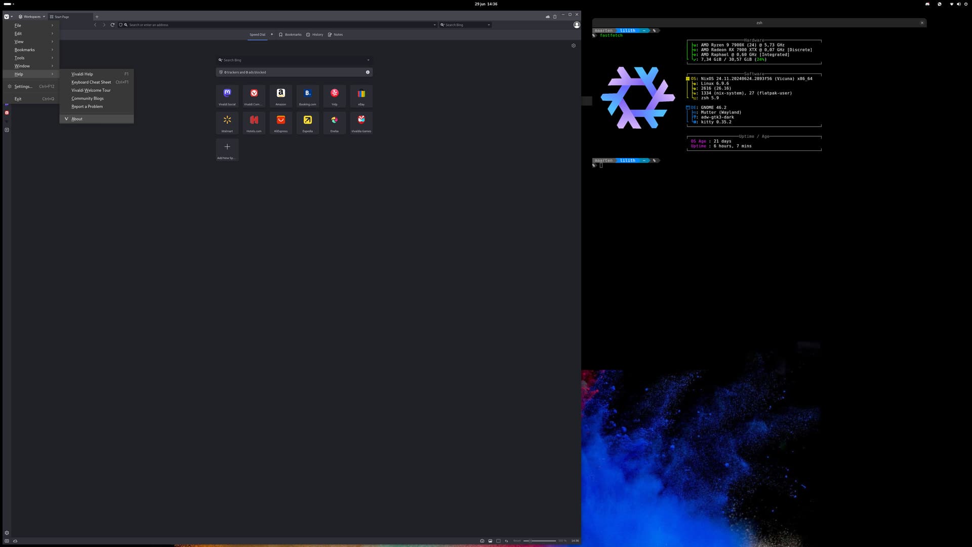

If so, then it’s not a Gnome problem since it works on NixOS.

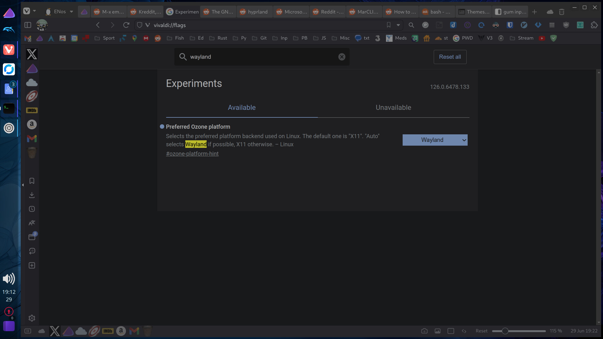

Go to vivaldi://flags, enter wayland in search box and set flag:
I forgot about that setting, OP just had to launch Vivaldi once with the Ozone platform afterwards is launched normally without needing to use Ozone.
