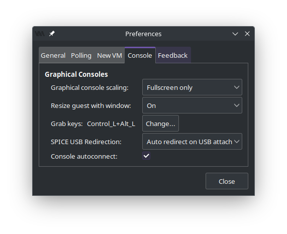

When I maximize the window of virt-manager, the VM does not expand to take up the space. It is also at a low resolution.
I have View/Scale Display set to “Always” , and the “Auto resize VM” option is checked, and greyed out.
In the guest, I installed spice guest tools and virtio-win-guest-tools, and enabled the services.
I can auto-resize this same virtual disk successfully when I run it on a debian-based distro.
On the EOS host, I have qemu-full installed.

If guest has spice-vdagent already installed, enabling “Resize guest with window” should be enough
vm
Still no luck
Overlooked that your guest is Win. In such case, the only thing I can suggest is to try to install vdagent for Windows (if it’s not already there)
By the way: do your VMs (Linux guests) boot/work as usual after recent system update? Asking, because yesterday I updated my machine and it introduced some new problems
Thanks for the ideas. I didn’t have any VMs other than the Win10. In the meantime, I kind of got frustrated with qemu/kvm, so I went back VirtualBox.
