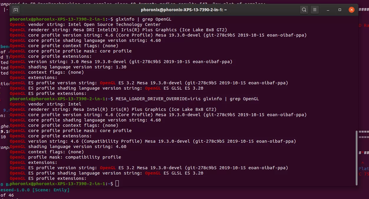

I think this may be helpful.
image.php
I tried
MESA_LOADER_DRIVER_OVERRIDE=iris
(Just entered it in the terminal and pressed enter - do I need to add it to a config file somewhere?)
It didn’t give an error, but the issue wasn’t resolved. FWIW, glxinfo wasn’t installed, so I installed it (via mesa-demos) and now that I have installed it, it just gives the following error:
Error: couldn't find RGB GLX visual or fbconfig
(Any thoughts on that?)
Then I installed mesa-git (from AUR), which is mesa version 20.0, and that didn’t resolve it either.
Any thoughts/reactions/ideas?
