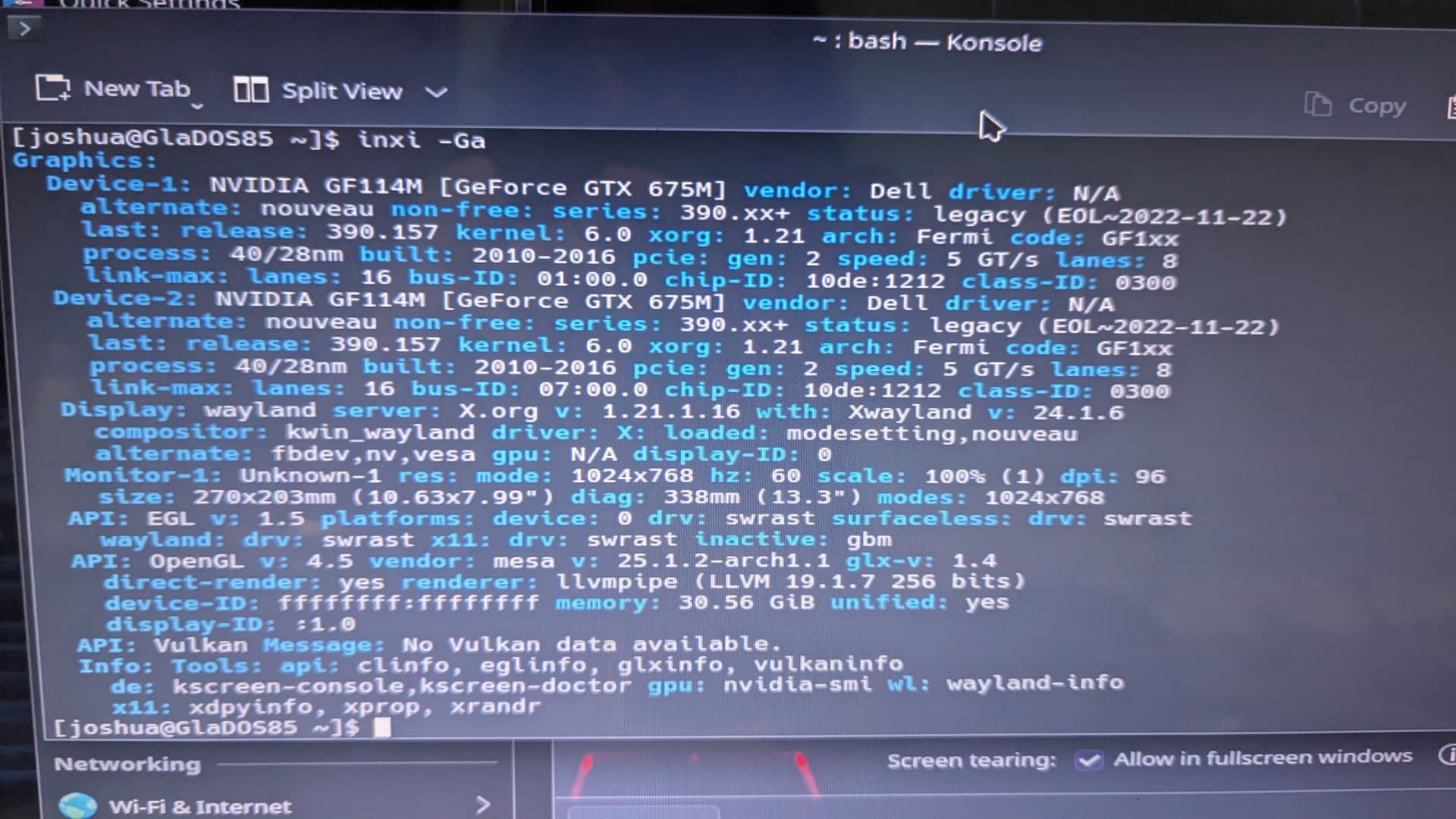

I have an Alienware m18x R2 laptop. It has dual nVidia 675M GPUs (SLI)

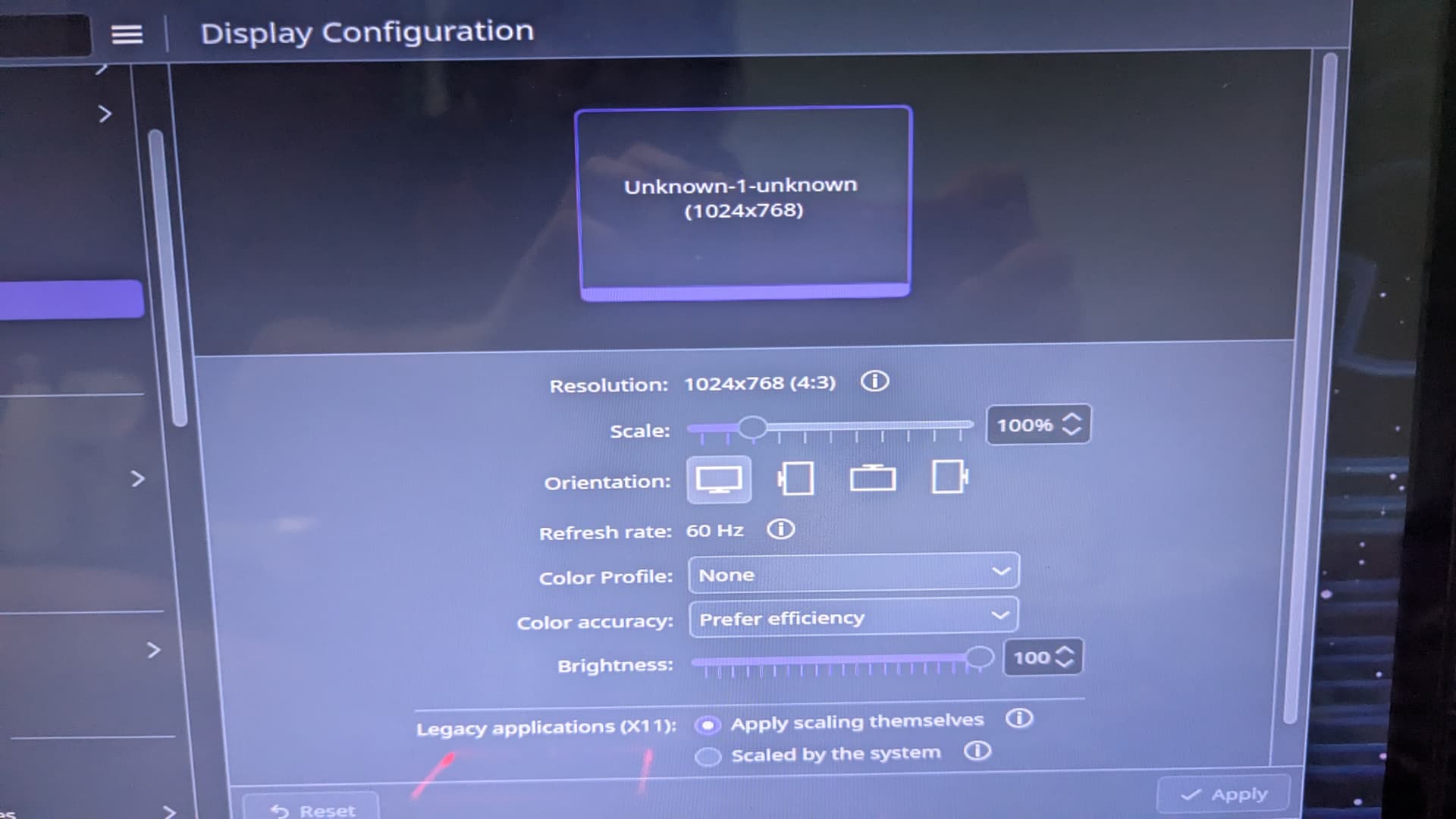

It was fine on initial install, but now (probably after installing Steam) I’m stuck in 1024x768 on “Unknown-1-unknown”
I’ve tried (re)installing nouveau drivers and running nvidia-inst
Nothing is fixing the issue.
Attaching screenies.
Any suggestions?

For the record, what’s the output of command
pacman -Q | grep -P 'nvidia|nouveau'
Your graphics card drivers are showing as “N/A” so they got messed up somehow.
Follow the command from @manuel above so we can see what nv packages are installed.
Though I also wonder about the “installing steam” transaction - this should not break your drivers. How was steam installed? Was it a a partial upgrade somehow?
