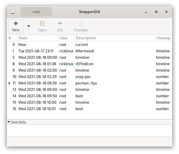

The rest of it i sort of understand. I am using the systemd timers because my knowledge on cron is not good. So this is easy as i am used to setting services using systemctl. Doing manual snapshots i can follow.
So i also installed grub-btrfs so the snapshots show up in the grub menu. I configured the snapshot time limits. I did not set access for non root users since I’m the only user i didn’t think it matters to change that.
I also tried to follow the videos and the arch wiki for Backup non-Btrfs boot partition on pacman transactions. The videos were a different hook and even the one in Arch wiki did not work. They both complain about it won’t run due to some dependency issues.
So i installed snap-pac from the AUR and it works flawlessly to create a before and after snapshot.
I also enable the snapper boot timer.
So i think it’s set up correctly and working. Not totally understanding why we need 4 subvolumes if it only is taking snapshots of @?
Also to know how to use the snapshots to restore? Is this done from the terminal with commands only. I don’t think the snapper GUI tool is for restoring just for creating snapshots i think? Or i have to chroot to do it everytime. Or that’s only if it won’t boot?
Edit: It looks like it’s all working.
Edit2: I only have this config because i didn’t create a /home partition. If i install this again i may add that.

When you choose to snapshot your home subvolume, it uses the parameters defined in the config file that you have created. The snapshots then will be put at @home/.snapshots. Hope I got that right.
No. But you have a separate home subvolume.
Creating a config is what allows you to take snapshots. The configs are not snapshots themselves.
If you create a config for home, you then have the ability to take snapshots of /home
If you have the snapper-timeline or snapper-boot timers enabled, it will start taking snapshots. If not, nothing will happen.
