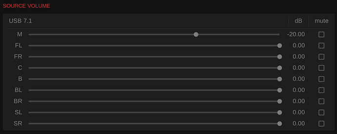

Hi Guys,
Hoping someone can help. I’ve got a Qudelix-T71 which is always stuck at -20db on the input setting. I contacted Qudelix and they said anything that supports UAC-1 and UAC-2 shouldn’t have this issue. Is there something I need to change in Pipewire settings to allow full support?
Clutching at straws really but hoping someone else might have had a similar experience.

It looks like Linux doesn’t touch the main volume only the FR and FL and looking at a similar issue from android
It seems that for some reason Linux isn’t reporting the right value
Interesting fact PS5 Mode reports the correct value.
