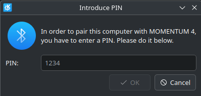

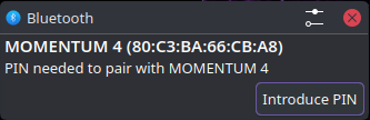

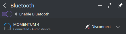

bluetoothctl notes
  • I get this notification when connecting to the device
    Screenshot
  • I’ve tried entering 1234 and 1111 as the PIN, all with the same result

  • It does connect for a while, but never shows up as an audio device in the system settings and then disconnects again after a while
