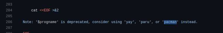

I checked the file: /usr/share/endeavouros/scripts/welcome and it seems that this message is not coming from the Welcome app, it is coming from pacman itself. Someone correct me if I’m wrong about this please.
You are probably right? I was just trying to figure out what it all means.

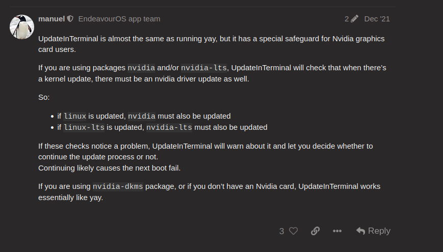

As far as I remember, the UpdateInTerminal helped with some Nvidia thing, I’m pretty sure that I saw this in a thread here..
Found it:
Not sure about the reason why it is now deprecated, probably because it isn’t necessary anymore ?

Nvidia part:
