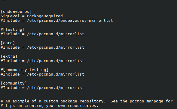

good evening - again otrott - is this correct here
did i comment out all the necessary lines here
look forward to hear from you
  • and besides that: if the process of commenting out was successful . then i need to store all the stuff - how to store the file that was opened via terminal!?

here a overfiew
#[testing]
#Include = /etc/pacman.d/mirrorlist
[core]
[extra]
#[community-testing]
[community]
[endeavouros]
SigLevel = PackageRequired
#Include = /etc/pacman.d/endeavouros-mirrorlist
#[testing]
[core]
[extra]
[community]
and now i will correct the commenting and - will save all the things afterwards - subsequently

well i tried to correct now - the process of editing see what i have done
hmm - the question is now - how to store it - how to safe all the things i have edited

  1. Open a terminal
  2. sudo nano /etc/pacman.conf
  3. change exactly this in your pacman.conf
#[core-testing]
[core]
#[extra-testing]
[extra]
# If you want to run 32 bit applications on your x86_64 system,
# enable the multilib repositories as required here.
#[multilib-testing]
[multilib]
  1. save with ctrl-o and enter
5 . close with ctrl-xand enter
