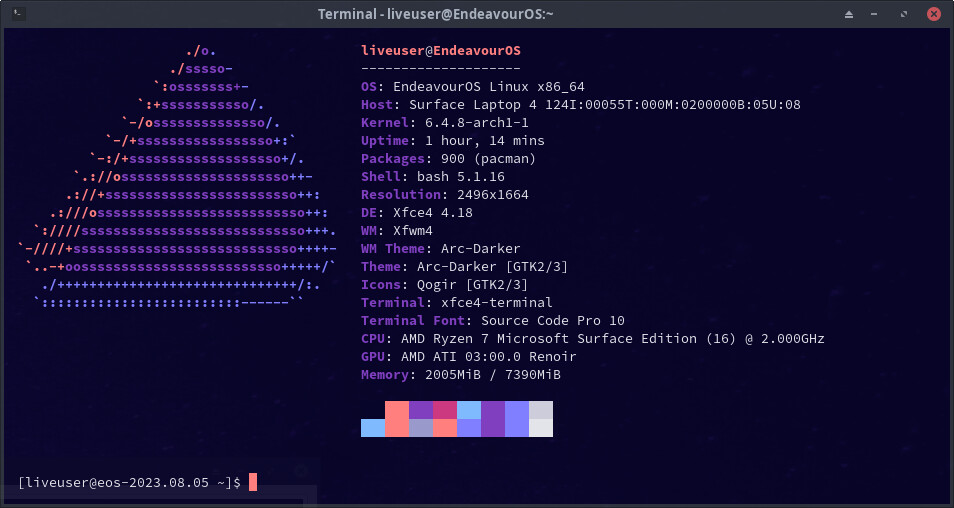

(Logged in on the live environment, pulled the neofetch;)

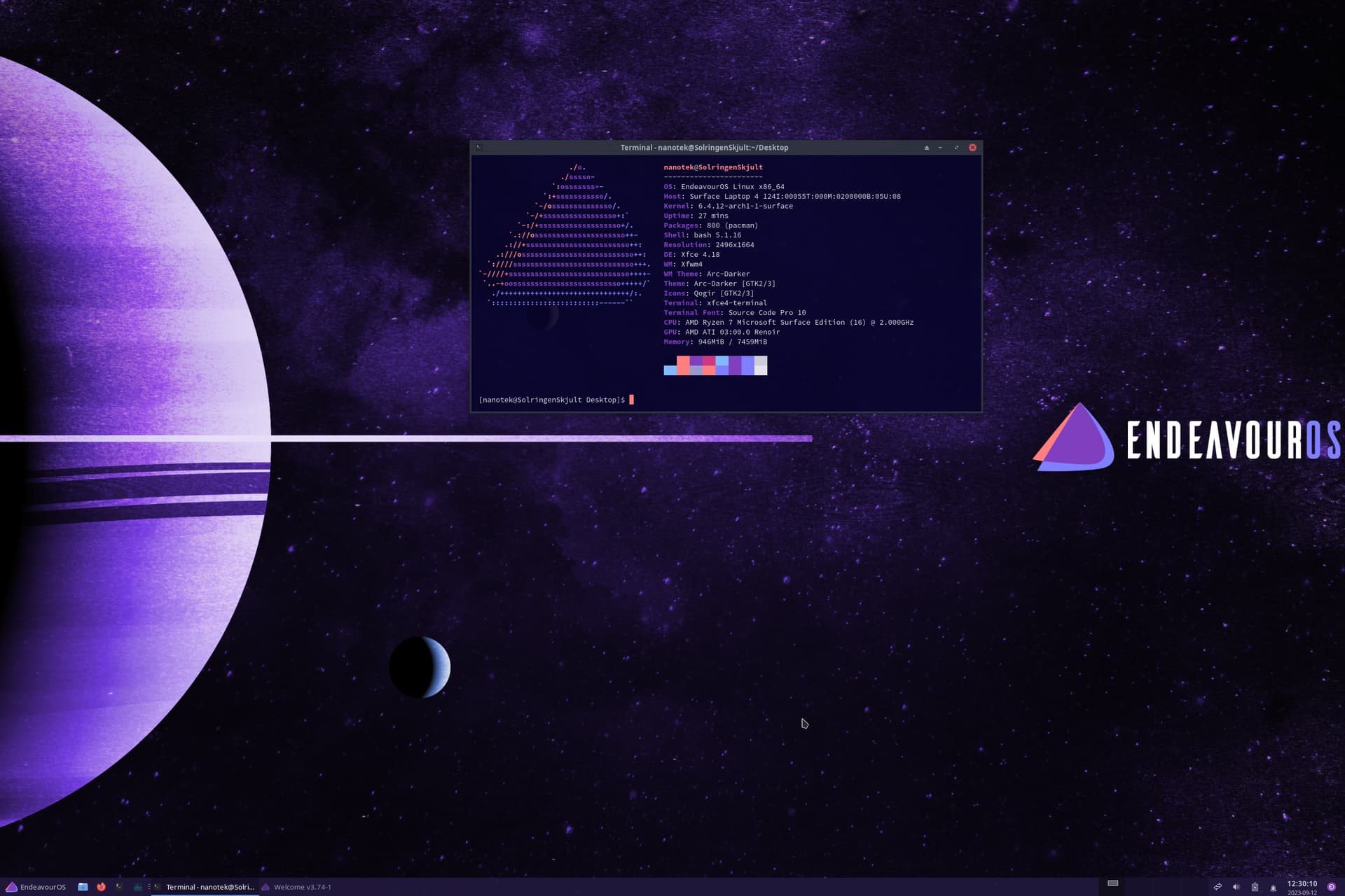

Edit: Proof:

Edit: Looks good!
