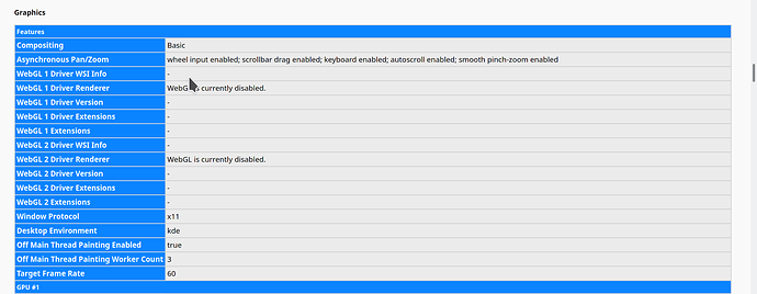

Does your system have graphics card? (integrated or discrete)
Also, open about:support on your browser and scroll down to the “Graphics” section where you can see the exact configuration on your browser. The relevant screenshot from my browser is here
You can see that my integrated graphics is being used to render WebGL.
hmm. mine have none!
Does not even have the driver… what on earth is that ? ! lol
solved.
it is this that causing the issue…
Thanks @Flyingcakes for leading me to a good tool: about:support :+1:
about:config
webgl.disabled=false
