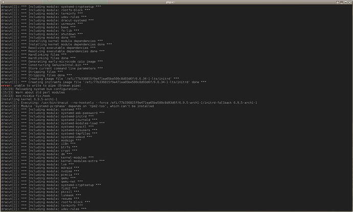

Unable to write pipe
I am wondering if I should be concerned with this error. It occurred during a yay update.
No, you can ignore that error. I am not sure what is happening there because it is hard to reproduce.
However, the initramfs is being properly written.
I should not have closed the terminal so fast. I would like to study it now. I suspect it was trying to create the image file one way. It did not work because tpm2-tss could not be installed. It apparently tried again, and was able to proceed because tpm2-tss is installed now. Its top down as far as the processes being executed, and what is shown on the screen right? Ive always assumed it was.
No, that message is totally unrelated to the broken pipe.
That message is also harmless. It is just letting you know that it tried to install the module systemd-pcrphrase but it failed because it could find the tpm tools. This is fine as you don’t need that module.
Look in /var/log/pacman.log
Ok. But I do have that module;

In the pacman log. It gives this block of text several times in a row.
[2024-06-19T15:21:47-0700] [ALPM-SCRIPTLET] dracut[E]: Module ‘systemd-pcrphase’ depends on ‘tpm2-tss’, which can’t be installed

It then transitions to this. Im wondering how it got past the error. I do not see it in the text unless it just stopped trying.
2> 024-06-19T15:22:04-0700] [ALPM-SCRIPTLET] dracut[E]: Module ‘systemd-pcrphase’ depends on ‘tpm2-tss’, which can’t be installed

You don’t have the required binary for that dracut module. It is part of the package tpm2-tools which most people wouldn’t have installed.
Yes, it builds two initrams for each kernel you have installed.
Despite the fact that it is identified as an error, it is purely informational. It won’t stop or hurt anything.
Thanks for your explaination.
