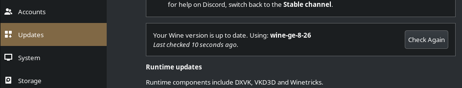

Open settings and switch to “Updates”. Here you should find the possibility to search / download WineGE. Click the button and WineGE will be downloaded. Also, GE-Proton is downloaded.

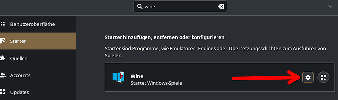

If both were downloaded, switch to “Starter” and search for wine. Open the Wine-settings.

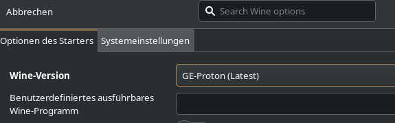

At the top, switch Wine-Version to “GE-Proton (Latest)”.
