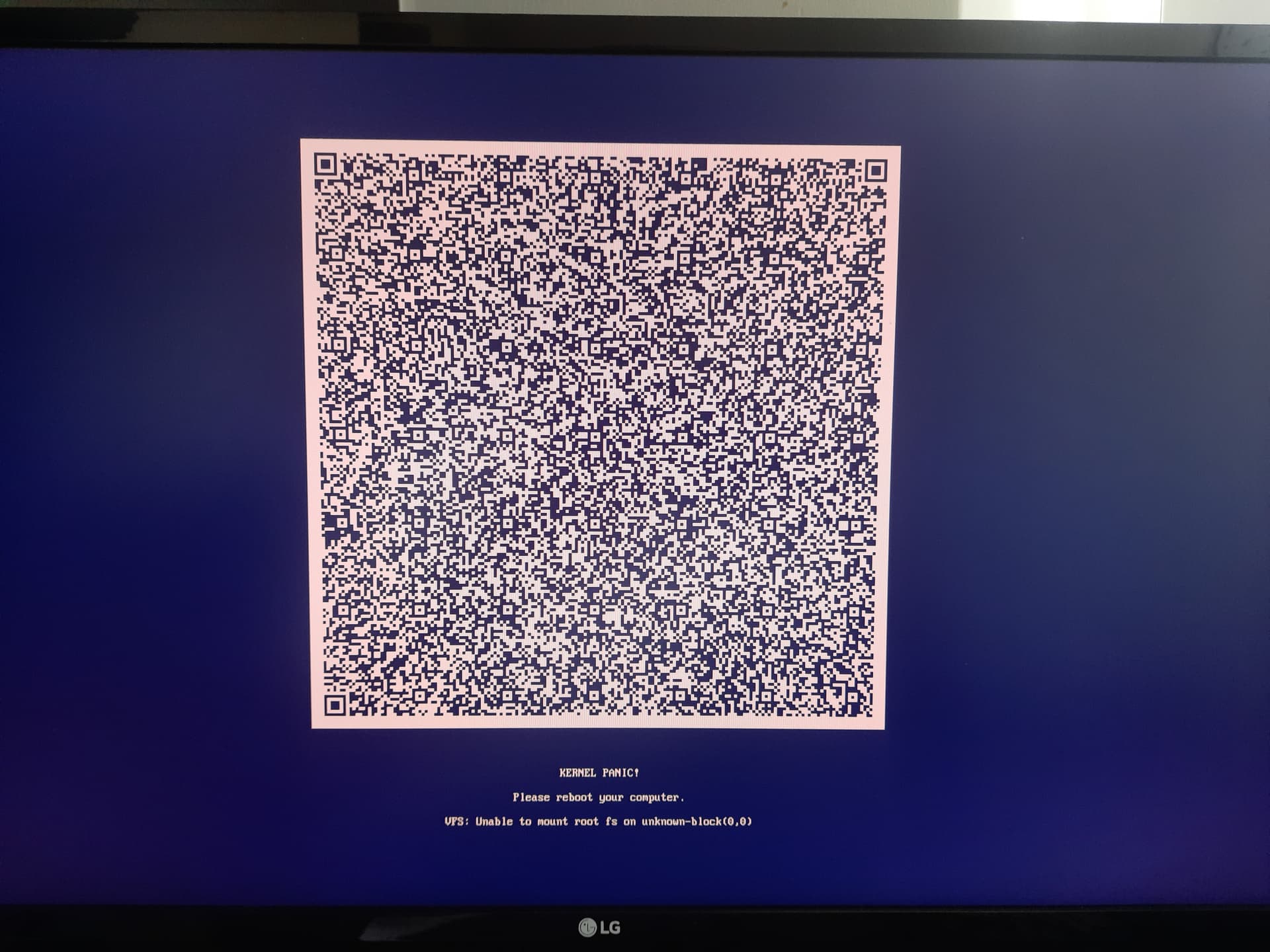

error: file ‘/boot/initramfs-linux.img’ not found
After that there is a kernel panic,
VFS: Unable to mount root fs on unknown-block(0,0)
All help appreciated.
That almost always means the update didn’t finish successfully.
You should boot off the ISO, arch-chroot in following the “arch-chroot” article on the EOS wiki.
Then run dracut-rebuild
from the chroot.
When running dracut-rebuild I get the error:
Failed to find module ‘zfs’
FAILED: /usr/lib/dracut/dracuf-install -D /var/tmp/dracut.dGPVsIU/initramfs -H --kerneldir /usr/lib/modules/6.15.2-arch1-1 -m zfs
installkernel failed to module zfs
Are you using zfs?
Yes
What happens if you run modprobe zfs
before running dracut-rebuild
FATAL: Module zfs not found in directory /lib/modules/6.13.7-arch1-1
Are you in the chroot?
If so, what does pacman -Q | grep zfs
return?
zfs-dkms 2.3.2-1
zfs-utils 2.3.2-1
You may need to install zfs-dkms
outside the chroot.
Exit the chroot and install zfs-dkms
then go back into the chroot again.
When installing zfs-dkms I got an error:
ERROR: specified kernel image does not exist: ‘/boot/vmlinuz-linux’
error: command failed to execute correctly
Is that in the hook at the end? If so, that is fine, you can ignore that error. It is failing to rebuilt the initramfs but that doesn’t matter since you are on the ISO.
Sorry I don’t exactly understand what you meant
dracut-rebuild still shows the same error
I tried installing the newest ISO and doing it again on that but same result.
I removed zfs-dkms and zfs-utils and dracut-rebuild finished successfully and I now have access to my system again, without my zfs pool however.

That is normal and probably the cause of your issue in the first place.
It takes time for zfs support to catch up with new kernels. It is better to use the LTS kernel when relying on zfs.
