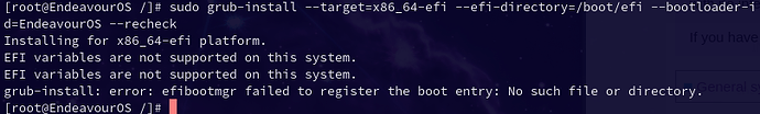

I followed some steps and tried to reinstall grub, but it fails saying that “EFI variables are not supported on this system”… I honestly don’t know what am i doing wrong. Its a fresh install i didnt even have time to break it.
Here are some photos of what’s showing up:
Screenshot_2022-09-30_18-32-38

recheck all options in your UEFI boot :
  • Secureboot desactived
  • no Fast , CSM or Legacy
  • all disk on AHCI
before chroot , check
inxi -Fxza
test -d /sys/firmware/efi && echo efi || echo bios

Yeah, the problem is that it’s UEFI not Legacy. And it keeps telling me that “EFI variables are not supported on this system”.
Have you enabled legacy-boot in your UEFI bios then? Seems it must be something in the UEFI settings? Did you get the latest update for it yet?
I just downloaded eos again and written it to fresh drive and installed it again. Will see if it happens again. Thanks everyone :slight_smile:
looks like your firmware resets USB boot to use csm/legacy Bios mode so the ISO itself was booted into legacy mode and was not able to recreate UEFI bootloader…
