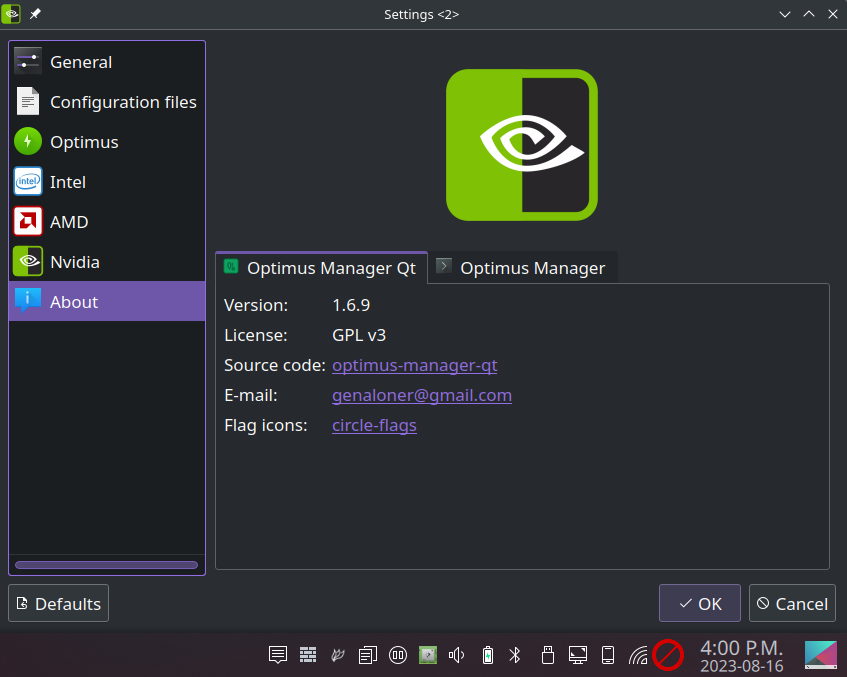

Hello,
I’m having a strange problem whereby two “optimus-manager” applets (one which seems to be working fine with optimus-manager, and the other which has a broken icon and looks for a non-installed envycontrol) are starting in my taskbar with my Endeavour OS install.

How can I identify the application associated with the broken version, and remove / prevent it from loading?

Optimus GPU Switcher (the applet shown in the second screenshot), on the other hand, is a frontend for EnvyControl (provided by KDE in the form of an applet) that allows you to use EnvyControl via a GUI. This applet appears “broken” because it’s missing a dependency - you don’t have EnvyControl (the backend) installed on your system. I don’t use KDE, so I can’t be 100% sure. But it is likely that this applet came with a package called optimus-manager-qt-kde from the AUR.
There are no “two versions optimus-manager applets” here. These are two different applets. One is an applet for optimus-manager itself. The other one is an applet for EnvyControl.

But he does have optimus-manager-qt-kde installed, which provides this applet:
But that applet needs envycontrol to run, which isn’t installed on his system. Hence the problem.
