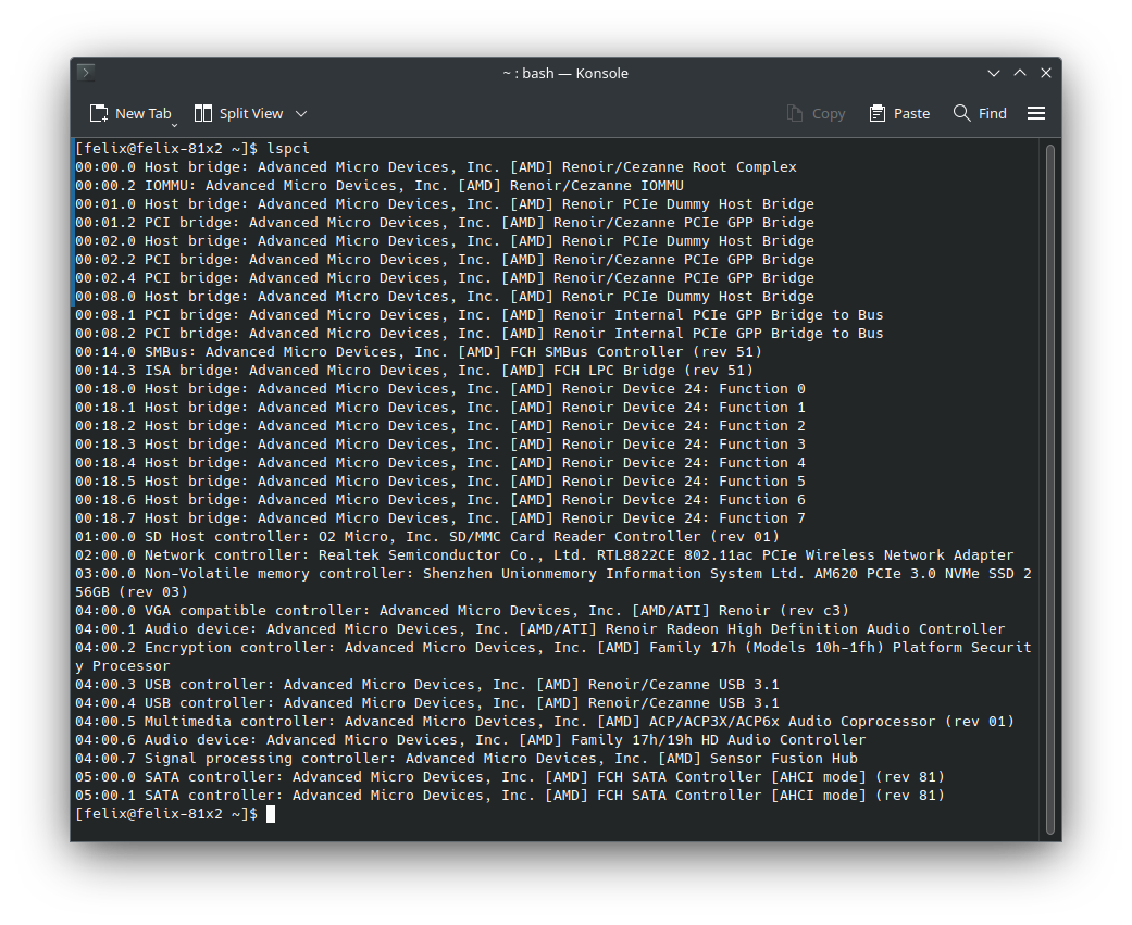

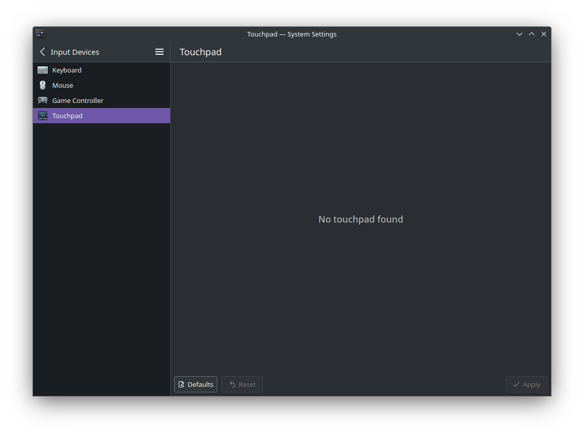

When I use my USB mouse, the cursor shows up just fine, but the touchpad itself is completely unresponsive, and the computer is saying that it can’t find it.

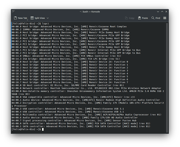

Here’s what came up using lspci:
I’m on a fresh install of Endeavour right now, and when I had it before, it worked fine, so I’m not quite sure what the issue is, or where to begin fixing it. My computer is a Lenovo IdeaPad Flex 5, and since it has touchscreen, I can still get around without the touchpad…but I still would like to be able to use it lol.
