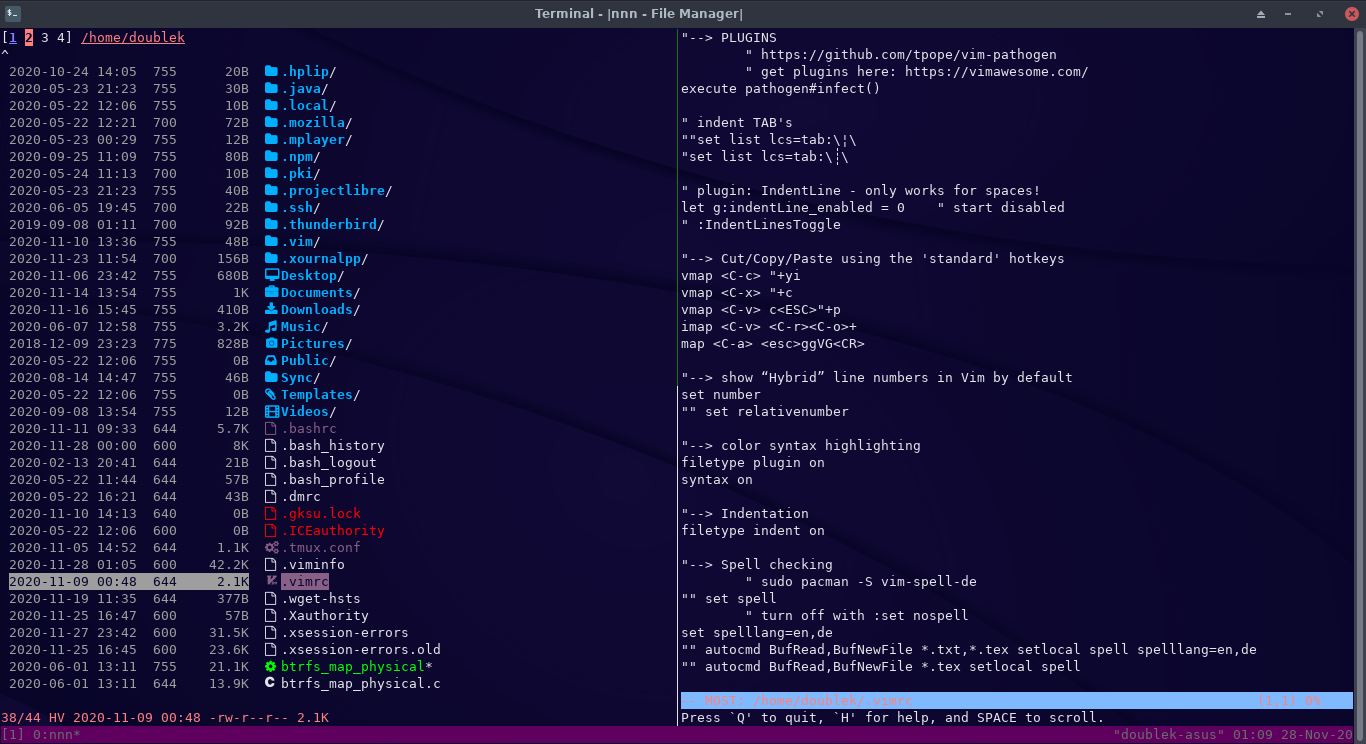

Since I run xfce and lack a tiling manager I use tmux in combination with the nnn terminal file manager if I need/want to preview files/folders in a tab.

Itβs supposed to be a much lighter and faster equivalent of ranger. Typically needs less than 3.5MB resident memory and has a tiny binary (around 100KB); so nowadays I prefer it to mc for ssh sessions.
But to be honest, for me it all comes down to it being βprettierβ than ranger.
Imo, if youβre accustomed to ranger (keybinds etc.) thereβs probably no point in switching.
