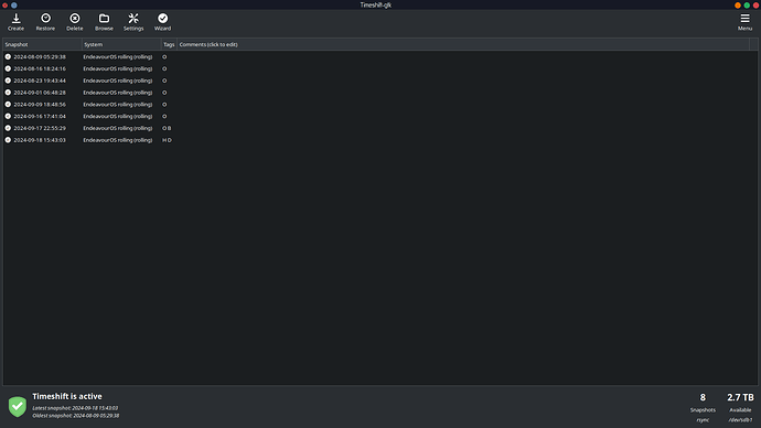

As soon as I ran that command all of a sudden it did its scheduled hourly and daily snapshot. I scheduled it to run those months ago. I attached a screenshot below. As you can see, nearly every snapshot has an ‘O’ tag, for ‘On demand,’ since I had to manually run them. How can I get Timeshift to run scheduled tasks without having to type sudo timeshift --check into the terminal?
